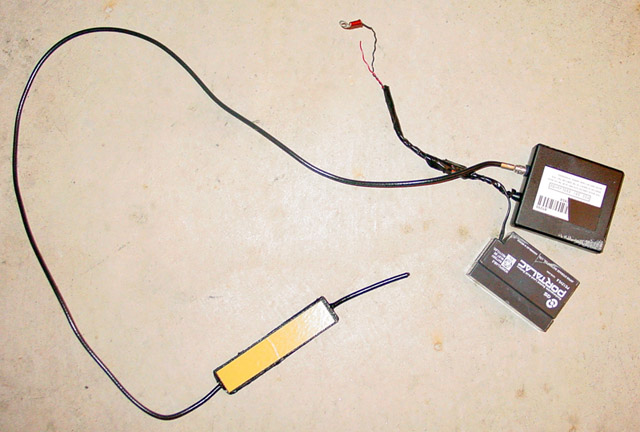

  3. It is probably LoJack, I removed a transmitter, antenna, battery pack and switch from my center console also after I bought my car. I didn't know it was in there and was hardwiring my V1 when I found it. Does it look like this?
