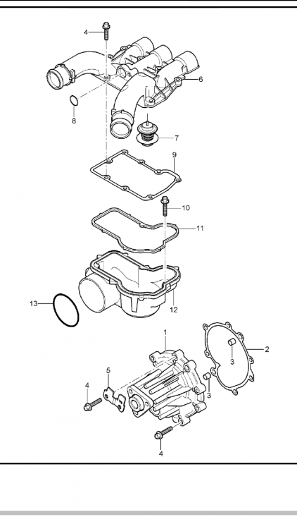

  11. i always believed there must be an air pocket which is causing my high temp but many of you point me to the thermostat. looking at the parts diagrams I can find two numbers. What's the difference? Can somebody help please. Is the part for the Cayenne s and the Cayenne turbo equal? Second question, where is sitting the temperature sensor ? Can't find it. Thank you.
