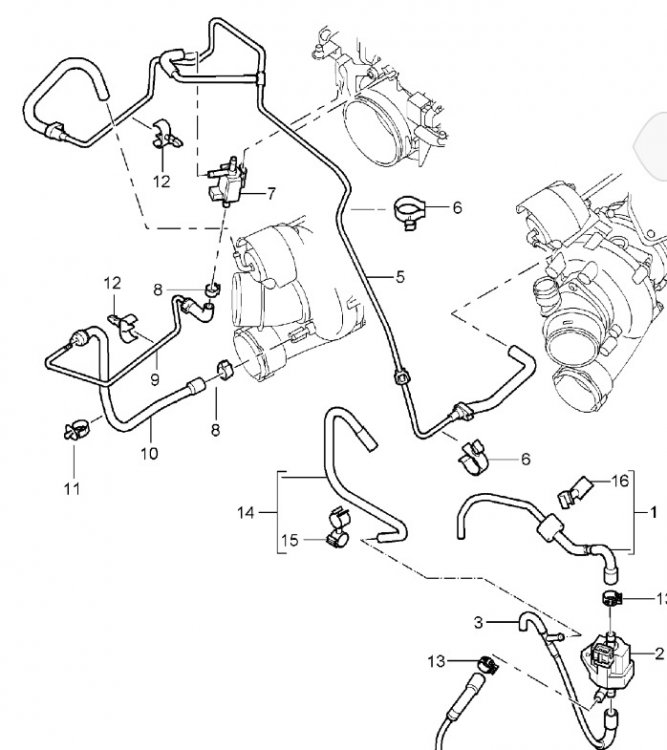

  2. Some time ago the picture from the area close to the driver side turbo charger was posted. See below the pic with the arrow. Is this the hose 14/ 15 ? If yes, is a replacement possible without taking away a lot of stuff? I need to replace mine.

  8. Here is onother question. I replaced today the pressure line (9+10 on the diagramm) which is going from n75 valve to the turbo. Dont know what it does?! I blow into the pipe and i hear the air coming out on the air duct which is connected to the air filter box. Is this right?

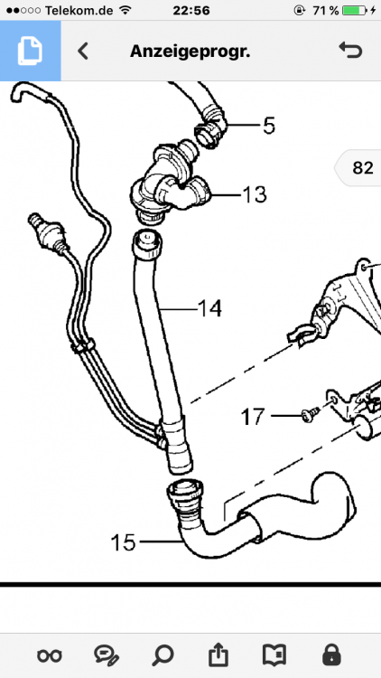

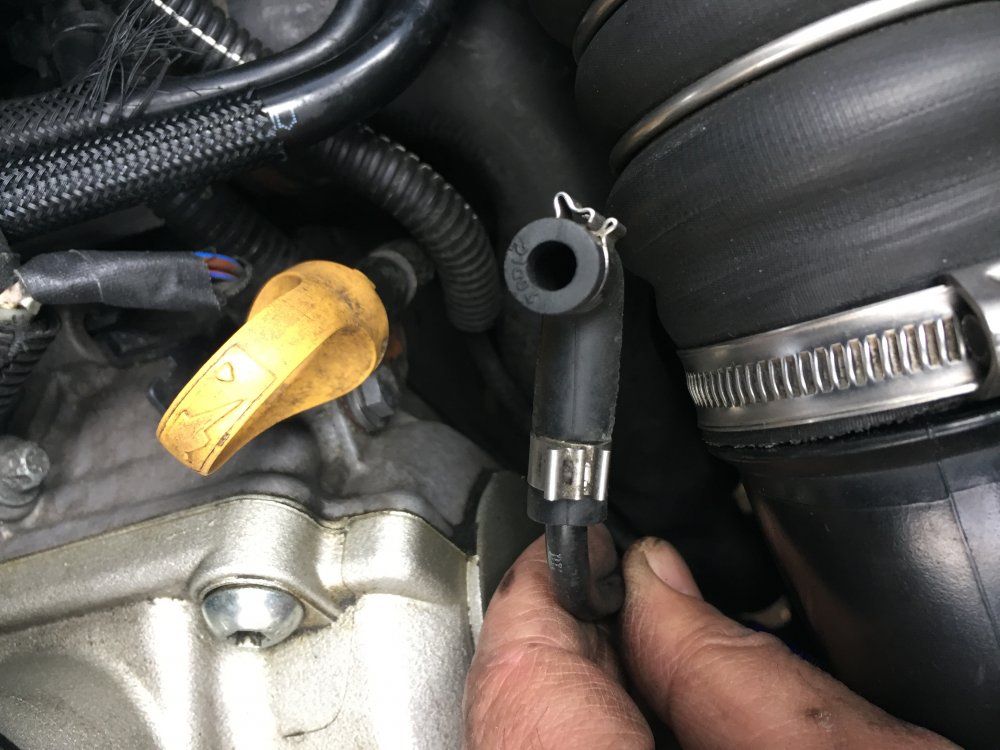

  11. This pic is from lewis. Showing the manifold from behind. No. 3 is the connection where your venturi tube has to go to.
  12. Here you see the tube. Going along the fuel rail to a connection into the intake manifold on the back of the engine. Take away the black engine cover on the firewall. Disconnect the passenger side air pump and you will have a very good access to this area
  13. Yes this venturi tube should be better connected . Its a friggle thing. Try to disconnect the y pipe to find out where this oil spray is coming from.

  20. I believe there is a o ring. Otherwise there would be metal to metal and this would feel different. I will find out. Here is a pic from a DIY which was made by a member here.
  21. Can this gap / old seal at the pressure hose cause a bad running or i am mistake with my theory?
