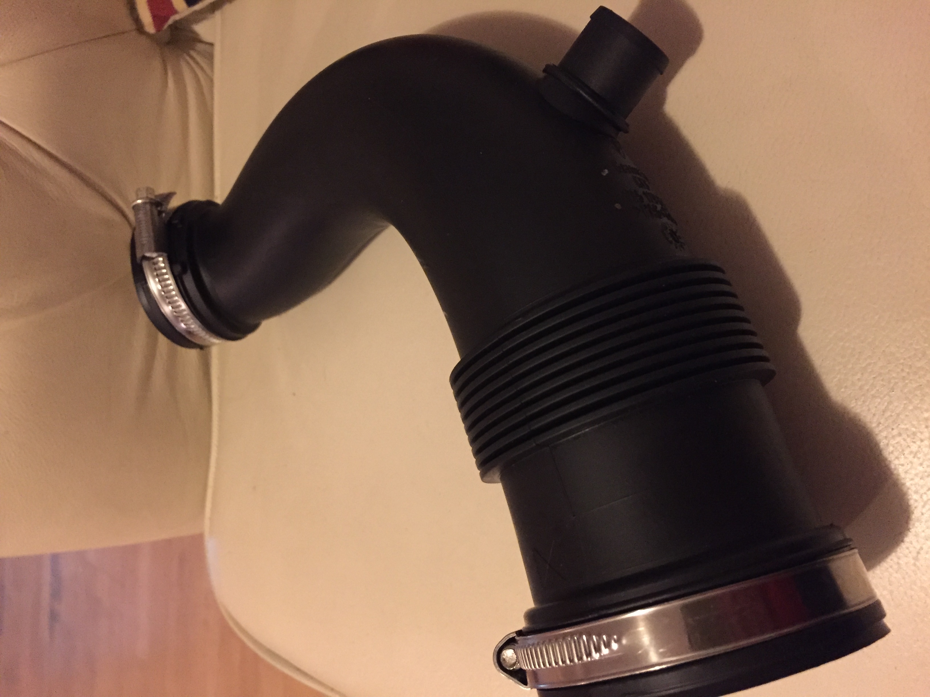

  3. So today at least i was able to change the air hose which is going from the turbo to the part where the MAF is located. Little bit teight everything down there but in the end could do it. Which surprise, the car runs better now. Couldnt feel the hesitation right now while driving. I will report how it will be next days.
