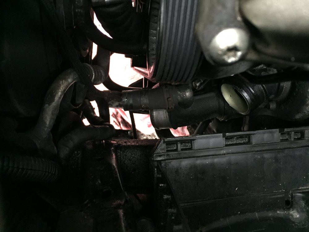

  3. I can post a succesfull repair as you read i changed and tried a lot to find out why this car is running so bad. Yesterday again all plugs new, checked the coils which are almost new. Changed the new MAF for the old again because thinking there could be a problem. Replaced the venturi tube. All in all nothing did improve the bad bad running engine. looking arround all the small tubes and hoses i found suddenly a small hose which hang arround. Close to the intake manifold close to the firewall. Its wasnt connected. Slipped from a valve because i was split in the end. Connected and. Wow. The Turbo is back. From the very beginning a smoother idle and a almost flueless accelaration. Testdrive. Changed again for the new MAF. Testdrive. German Autobahn without speed limit. Wow. Looks like i found the 200 missing horsepower. The car runs very good. Fingers crossed!!! thanks to lewis which constantly pointed me to a vacuum leak. For me a new lesson. what difference a single small tube can make which is not connected.

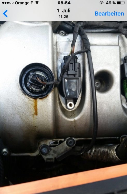

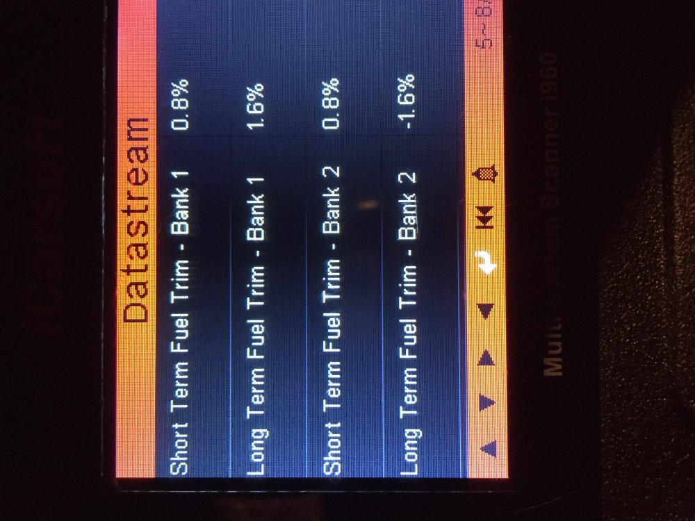

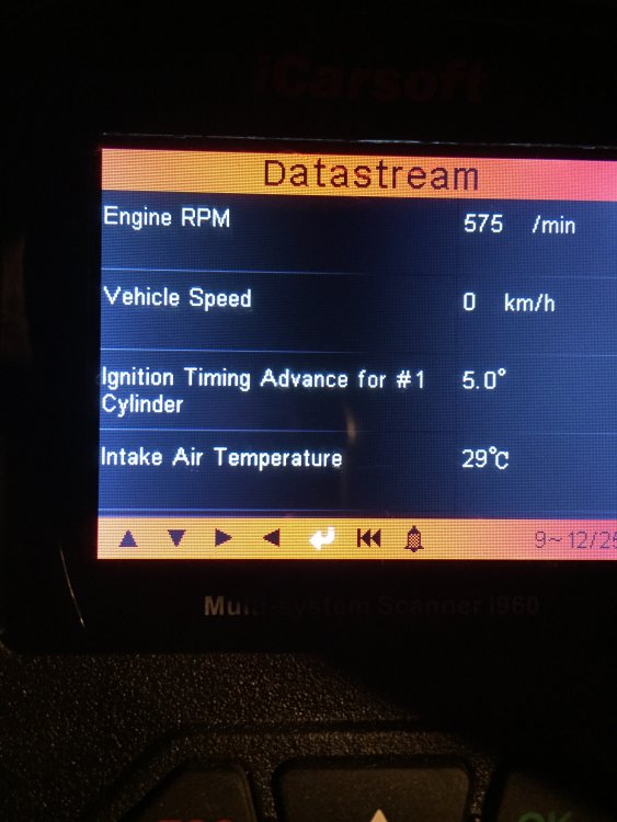

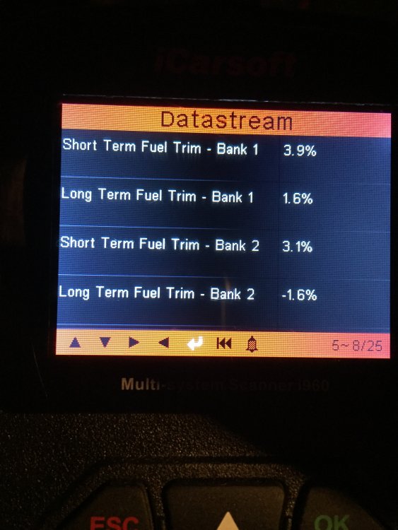

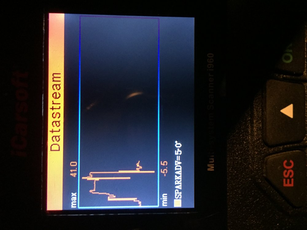

  8. Came back from my trip to france. Dont want to experience this again. The car was running quiet bad and i was really worried it could become even worse. Running like crap. No power. Rough running. Idle floating from time to time. Checked the coils - found one cracked. replaced one. now at home i changed all. same engine behaviour. MAF are new. Engine running i disconnected the MAF and to my surprise the same. What the hell is this. Dont have a piwis or durametric Check with my OBD scanning device. Please find the readings. Maybe the pros here have a idea whats going on. I am very worried its a timing issue. what i need to say, the car is showing this behaviour since my indy changed the valve cover gasket and later on the small round seal at the top which is the cam actuator solenoid i believe. What could went wrong during such a job which is causing this problems. thanks a million for your input sorry but i dont know why some pics are upside down

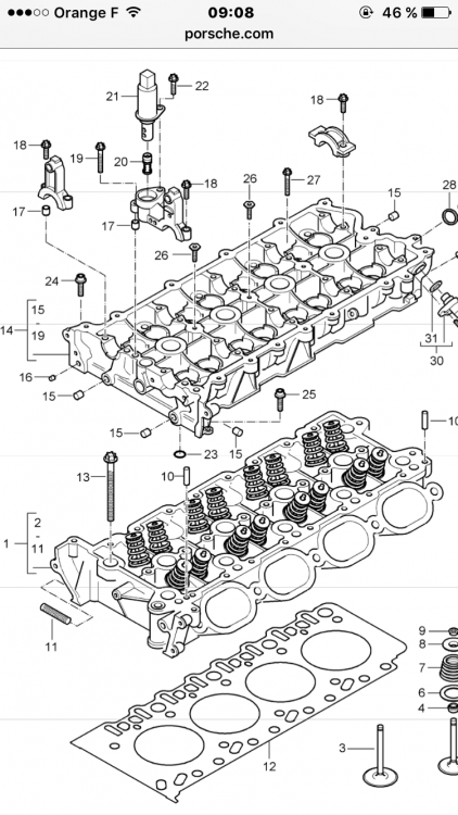

  16. Dont even know how old the coils are. I have the car now 4 years. I didnt change them. I just check them from time to time.

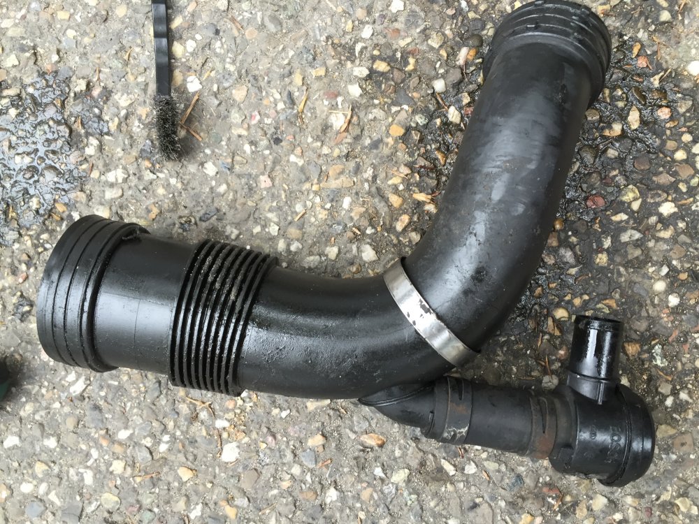

  20. On the highway to france. Car is not running nice. Feels not smooth. no power. Very bad fuel economy even while i am driving slowly. But this has nothing to do with the new DV. Was the same before

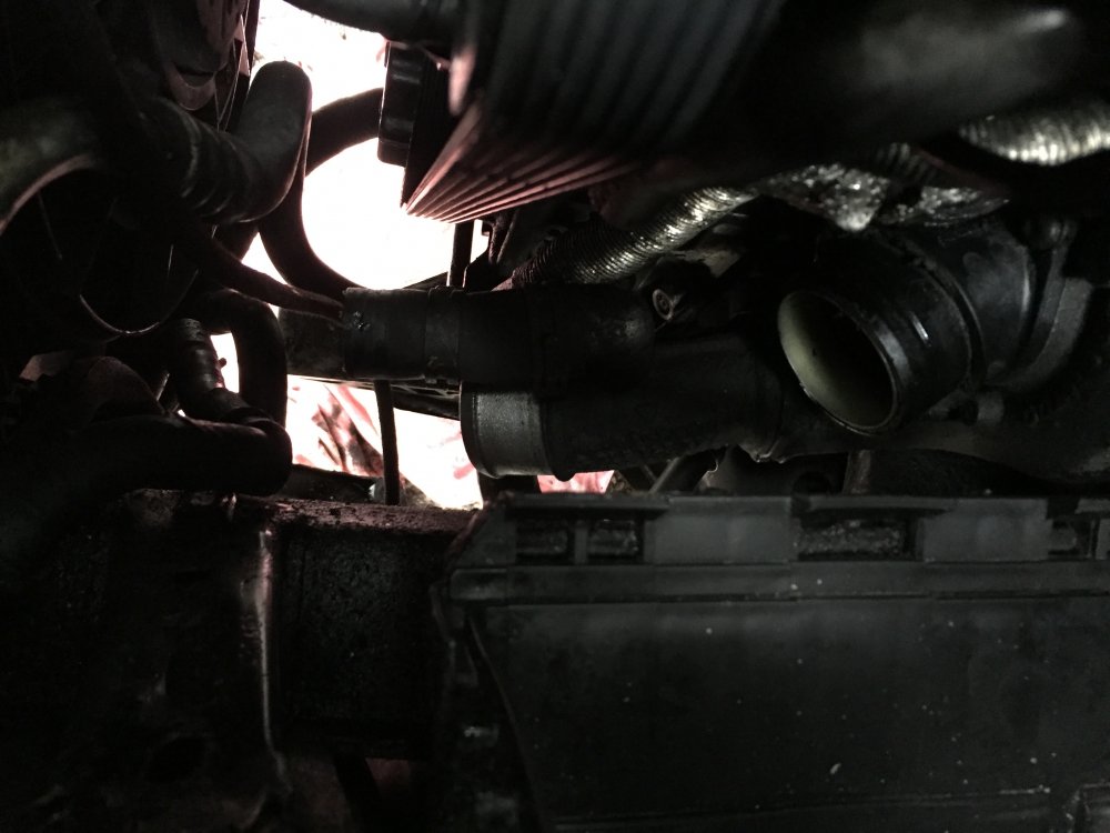

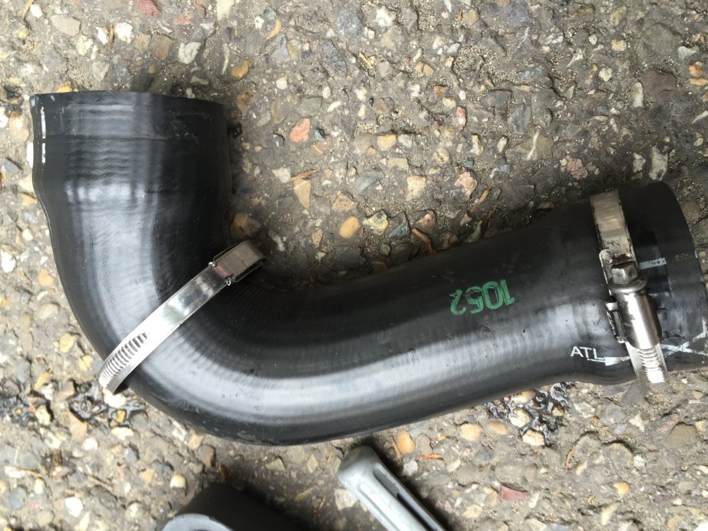

  21. I like to work with cars but in the end they have to drive perfect. I cant tell this from my turbo. At least i drained the intercooler hose. I will drive to france tonight. I hope there will be no bad surprises. The other DV i did not check. Because this side did not have any oil . Just replaced the MAF now. The hose you mention- last pic in my post- looks really a bit worn out. But its saturday. Shops closed. Couldnt get new one. I will see how the PIG is driving tonight
