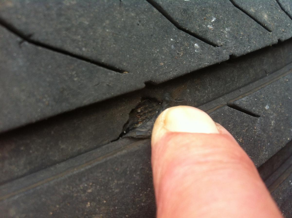

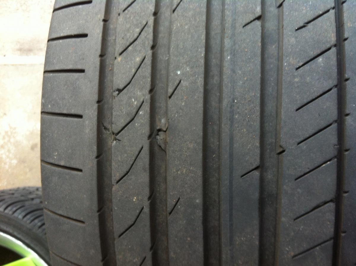

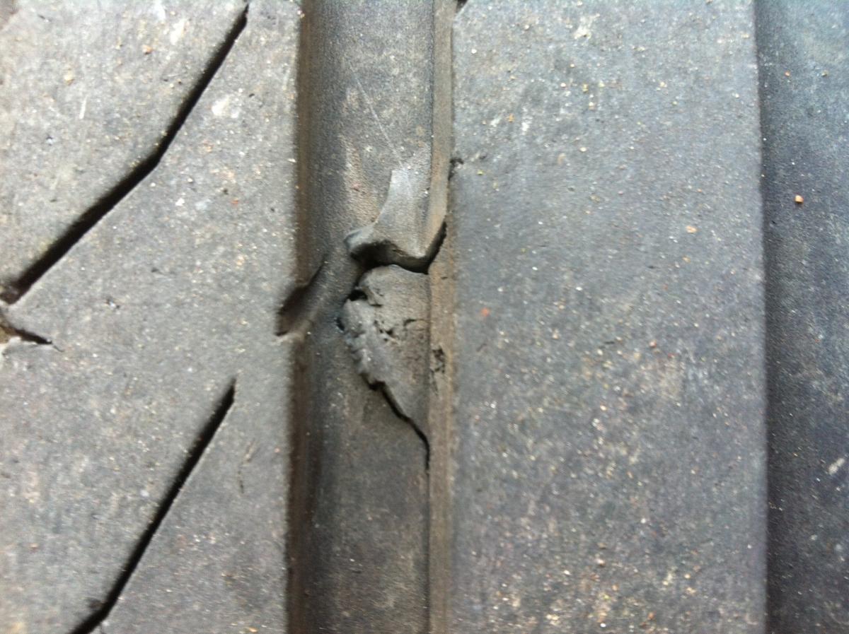

  6. Hi ! When i drive home from the shop yesterday i didnt feel it at the beginning . Just when i enter the city and i had to stop on many Traffic lights i noticed the temp went up really fast
  7. Thanks for writing. Radiator looks good. Coolant Reservoir is at the right level. I am just wondering how possible after having this new water pump Situation got worse.
  8. Decided to change the water pump on my turbo. Just in Case of a possible Failure and because the temp went above middle on low rpm. Today i take the car back. Driving in city Traffic . Stop and go. Temp went higher and higher In Directon of red area. Switched on heating to bring temp down. Called the mechanic and ask him if he refill the System with vacuum Equipment . Any idea what it can be? Thermostat maybe?
  9. Thankx everybody for your friendly advise. I will buy new ones.
  10. Thank you JFP. Went to the shop. Of course they want to sell me a new one. Better 2 new ones .
  11. Its a Conti Sport Contact but doesnt matter
  12. My Dunlop Sport has just 10.000 km and today i Noticed a damage . Please watch the picture. Dangerous to drive? Should i replace it?
