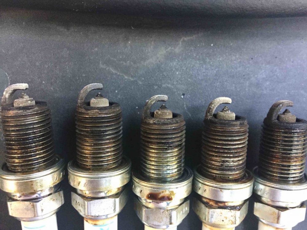

  1. Maybe the colour of the plugs has something to do with my oil consumption which is pretty high when I am pushing the car.
  2. Changed the plugs after 18.000 km. Any opinion about the condition?

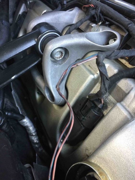

  4. As some remember maybe I had continuous fault codes with the camshaft sensor/ actuator. Timing on one bank not like it must be. I changed the sensors on the backside of the bank with no result. I was very close now to change the magnetic sensor in the front. Today I unwrapped all the isolation material. What i found very common already with my engine. Everywhere briggle and broken wires. Everybody with continuous faut codes should really check the wiring in the engine room. Now after 10 year almost everything in a very bad condition.

  18. Check the wiring. I had several wires with bad and briggle isolation. When it gets very hot the wiring is very soft and maybe they touch each other and problems occure.
