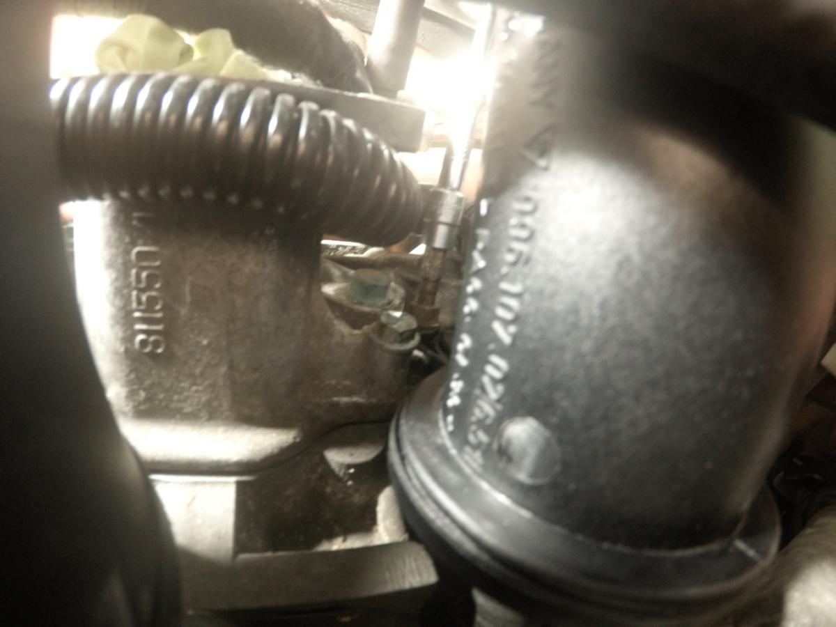

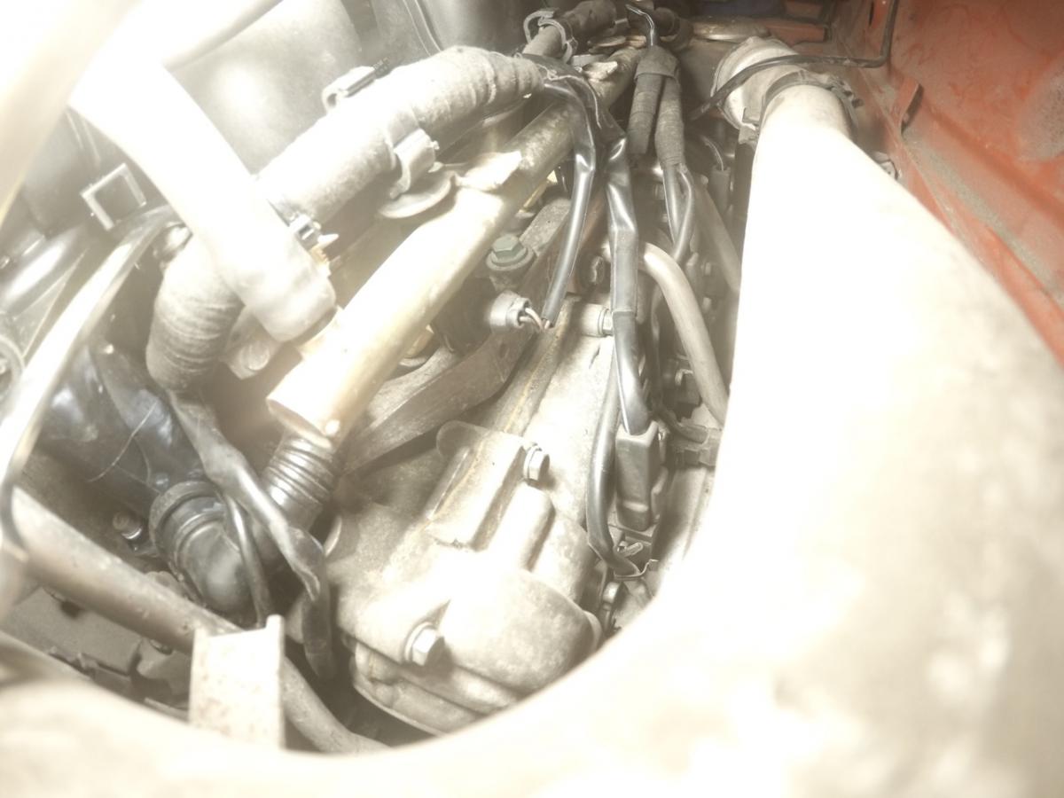

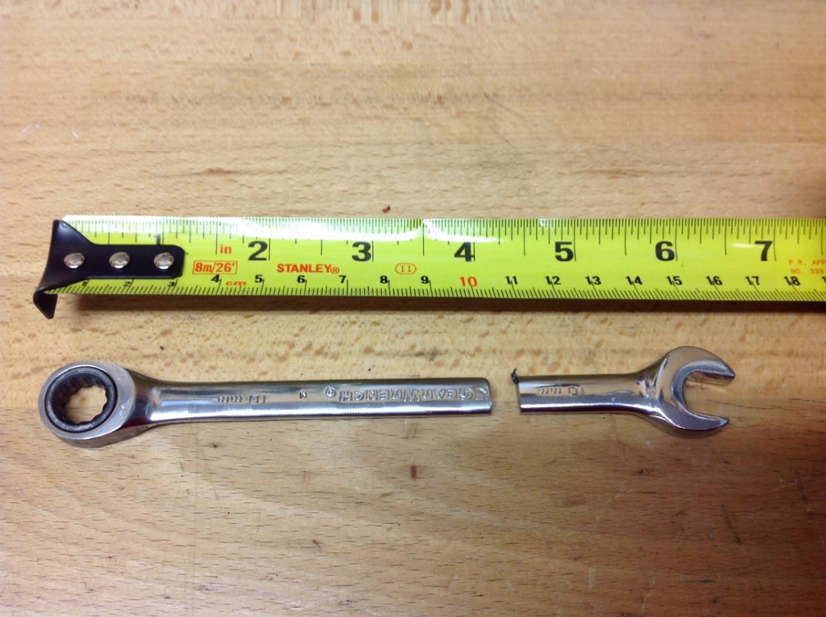

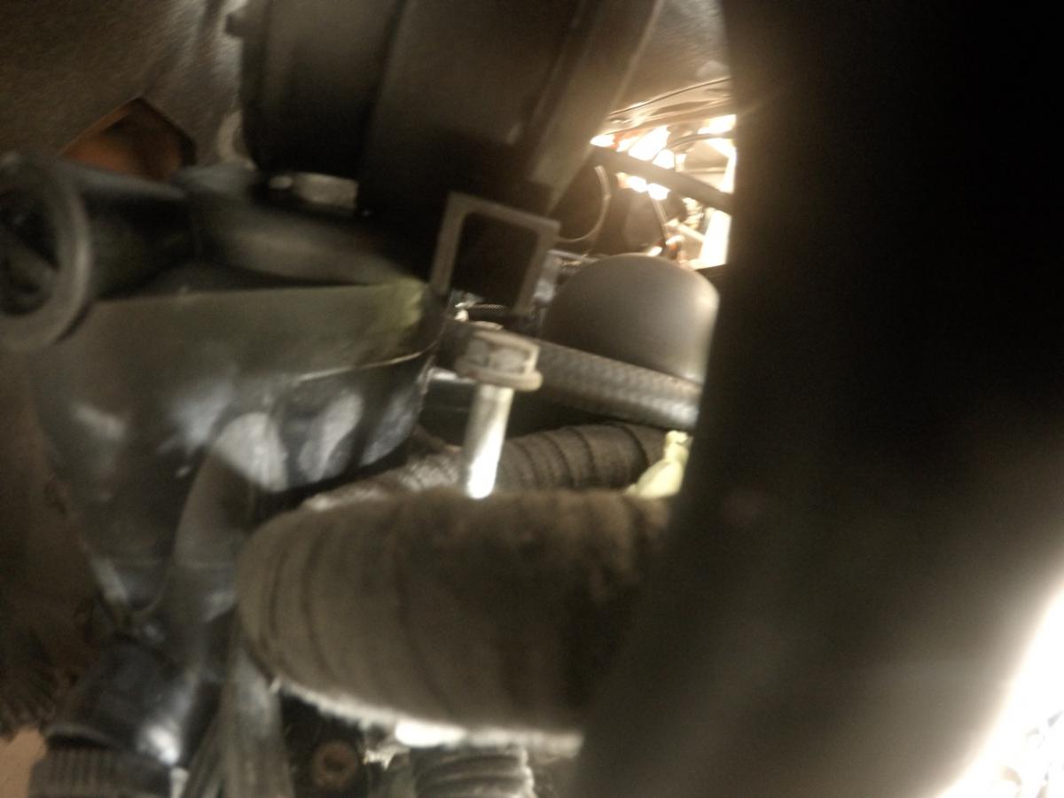

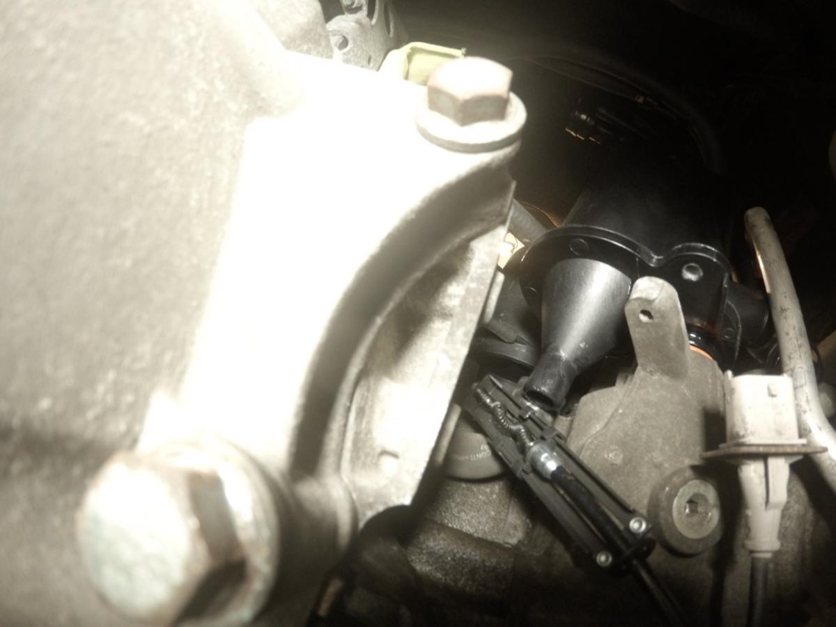

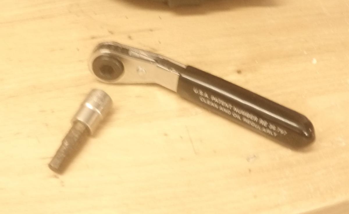

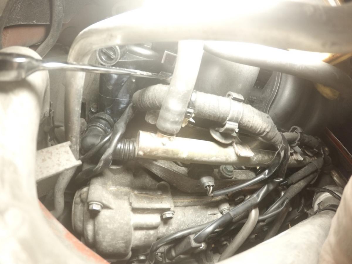

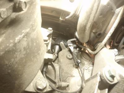

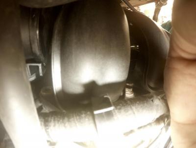

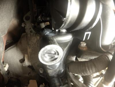

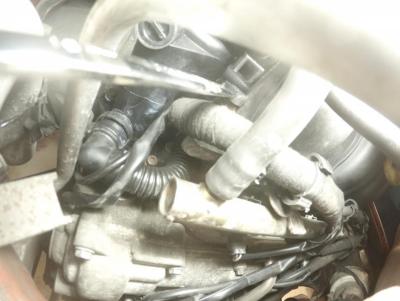

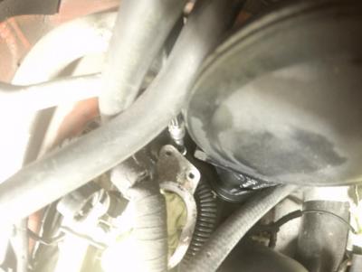

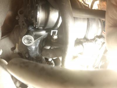

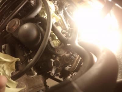

  10. As I said here are some pictures taken with the GoPro. I wish I had them before the project. They show pretty good how it looks like in the back. The wrench shown in the pics only worked for loosen the screw. For tightening I had to modify the ratching wrench. To unscrew the sixth screw I loosened it with the wrench and then used my left hand but I had to take the fuel pipe between the thumb and first finger. i have short fingers and I barely reached the screw to unscrew it. They turned very easy once lose. 2002 996 MKII engine 3.6 convertible Admin: Sorry for the many pics. Maybe someone can generate a PDF file out of them. I will try to write something up but next weeks are very busy.
  11. Done. 5 hours later I had it back together. I'll post later some pictures when I can find them on my GoPro. Here are my short notes: - I put the AOS first in and bolted it on (these short ratchet drivers from the link above are very useful) and then the manifold. - I preassembled the manifold connections to the other bank and slid in the manifold. I wasn't able to put in the two connection pipes in after I had the manifold installed. - I slid in the manifold with the last screw already in (there is no way to insert the screw after the manifold is in. - I bought a ratchet ring wrench from Advanced Autoparts (10 mm) and had to cut it to 100 mm (4 inches) length. Additionally I had to grind down the perimeter of the ratchet wrench so that it would fit the screw. - With the help of the GoPro 4 (and wireless live video streming on my iPad) I was able to put the wrench on the screw head. Was not that bad. Once it's on it was easy to ratch it down. - Installation of the coolant tank was only possible because the front edge of the black holder was broken. Previous owner or shop broke it. This allowed me to relatively easy slide in the coolant tank, Special tools needed: cable operated hose clamp plier and the modified ratching ring wrench size 10. GoPro made the installation so much easier. Now smokeless. Thanks to all for the helpful tips and how-to's. Especially Ahsai.
