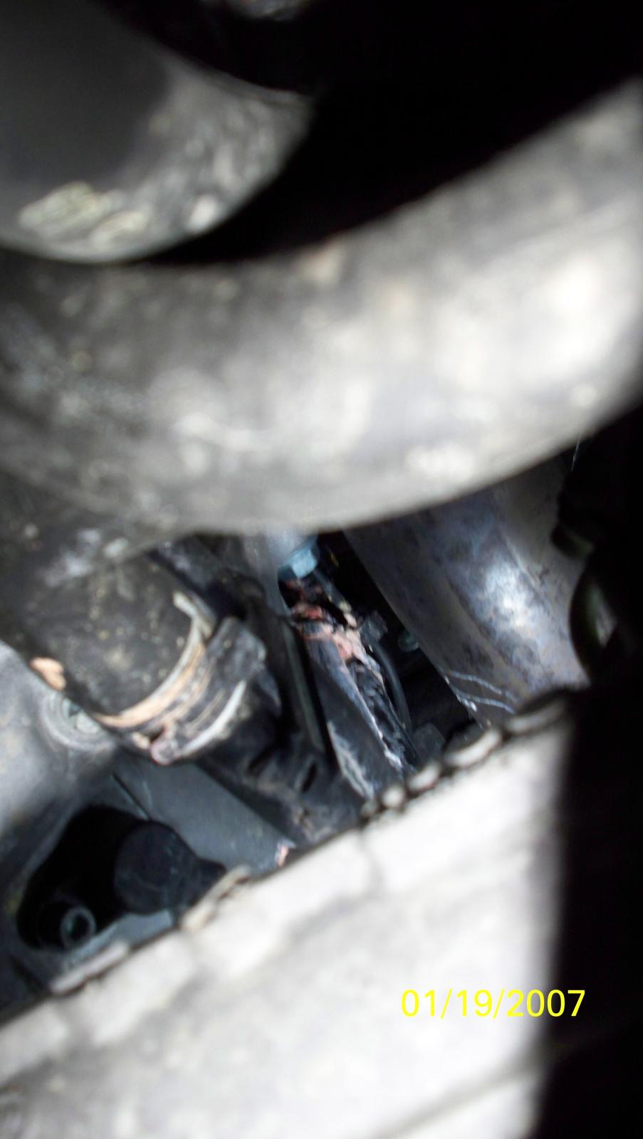

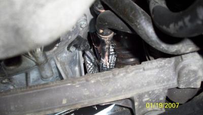

  8. I was laying underneath mine for about 30 min trying to figure out if I could band clamp my leaking line from above. I can almost get an arm up to the Ts from below but even if I could... no way to get a band clamp on and tight with one hand. Looking at it from below I realized that taking of the intake...getting at it from above and probably breaking a multitue of plastic and gasket, that I would have a heck of a time clamping it if at all. No room for screw driver at 90 degrees to plumbing. Would be nice if I could reach in from drivers side wheel well. The wheel well looks like layers and layers of trouble though. My line is leaking between the rubber to metal connect below the lower T. Also anyone know where these lines run to from the bottom T? They snake around the power steering pump then down the frame under the driver side and disappear.
  9. Thanks for the trail of info on this. Thinking the pink stuff is not sealer but escaped Pentofrost. I have one that has turned into a pretty good leaker. I can see pink at most fittings clamps on both T's in back.
  10. Thanks for your insight. I was about to post that I got a much better look tonight from below with both pans off. There are trace coolant leaks at both Ts but the more major of the leaks is from the second (lower) T where its hose connects to steel line. leading down. Was going to ask...how do I fix this since its not really broken. I think I wil try to fashion the brass T replacements that fellow from Perth posted recently..then dig into it and put brass in it and replace every clamp I can get at back there with screw clamp...or simply add a screw clamp over the flare. At least I know I am not in for a catastrophic coolant failure on this unless one of those Ts implodes...I must say thay look good and fresh but looks can be unreliable.

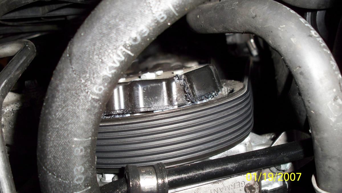

  12. Got a couple of pics of AC compressor while looking for coolant leak. Think McBit nailed it on this one. Have the mid body connector that trails off to the rear. The weird thing is that I am able to spin by hand what would be a magnetic clutch in front of the pully. It looks like something catastrophic happened to the "clutch"...crack in the casting with oil and freon leaking out indicates that as well....darn thing sure spins nice though by hand.

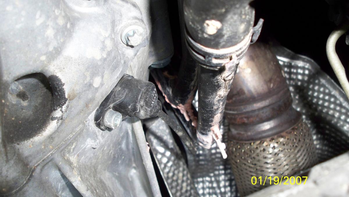

  13. Found the smell. Lot to be said for the pepto bismal coolant stalagmites. Followed the pepto trail drivers side. It's rubber down low then goes verticle on engine side of heat shield with multi bend metal lines. These lines run as a pair. Up high where it goes back to rubber from metal..it is leaking at a banjo clip and running down same metal line and dripping off where they go back to rubber. One line is leaking...not both. Can see it with an extended mirror from the bottom and the top but not great. Why would it leak here? Am I over pressured somewhere and this is the weak spot? The banjo clip seems to be where it is supposed to be. I can not see the hose that well but looks as though it is leaking rubber to metal unless there is a bad spot in rubber. Can't see it good enough to know. Newer to me cayenne. Had power steering line pop off at a metal rubber transition at a banjo clip when really cold this winter. Fixed it with a stainless hose clamp. This the same type of fix? Problem is how do I get at it? Also anyone know where these lines go to and come from? Can't tell if these are the notorious T's...does not look like it but hard to tell in the mirror. Been searching for a coolant system diagram and can not find one. Appreciated, John '04 Cayenne turbo 92,000 miles
  14. Thanks for the great info....The link to the denso site shows on page 20 that at the very least there is serpentine belt protection if the compressor locks. A limiter breaks allowing the pully to spin free. That is in the diagram on a 7se unit. The diagram indicates that that model is not a clutched unit. In my search for a new compressor the next problem is what to put back in it? Both the Porsche dealer and the bigger Indy Porsche repair place both told me that the replacement is clutched. All of my searching on the net..mostly e bay...shows the 7seu17c to be a clutched unit. Now that leads me to question the control aspect. Also makes me queston the information on this unit for e bay which indicates this model works on all v8 and v6 cayennes '03 to '08 which I kinda doubt now. Voltages to operate the compressors must be different between a clutched and not clutched unit. Maybe Porsche senses which unit it controls. I am also guessing that the car needs to be programmed that the compressor / ac system has been replaced. As long as I can drive it down, I will have Imola. the indy Porsche repair in Minneapolis just put in what it needs....clean everything out and replace compressor, dryer and expansion...o rings. Reprogram. I will know what they put in for replacement and report back.

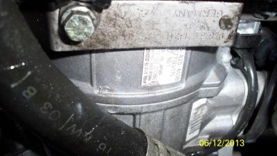

  15. The cracked compressor in this '04 Cayenne turbo is Nippon Denso 7SEU17C. When I was in a local general auto shop we looked up porsche replacement parts for that vehicle and it stated that the replace compressor is clutched for 4.5 and for the v6. I was in a suburban at the time... not the Cayenne. I am going to bring Cayenne into that shop and have him take a look at the compressor and decide if it is clutched or not. The tag on the compressor is the Nippon Denso 7SEU17C. ND Oil 8 R134a. McBit500 post shows it should not be clutched. Then we are back at the point of potentially seizing the pump while driving 250 miles to a porsche shop. Managed to attach photo! The inch long crack to the left of the tag in the casing is the culpret. I will get a photo of the pump pully and post that too...later after I can pull off shrud and get a pic.
