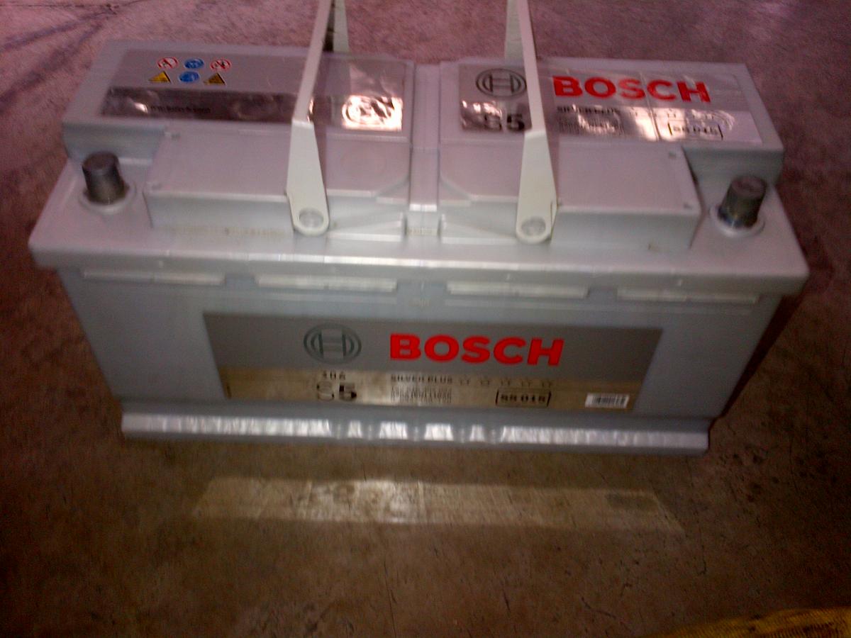

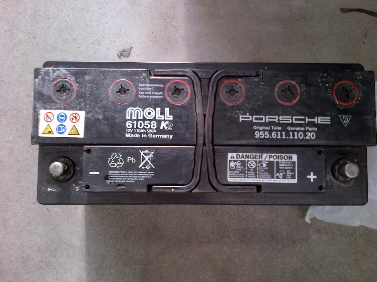

  4. So, today i changed the battery. I replaced the OEM batt with Bosch Silver S5. Same specs, but different brand. The Original Porsche battery, was made by MOLL, producer i did not heard until now. After the replacement, the PCM is still dead. Like the usual, it started in the morning, and after i stopped the car for the first time, it would not start anymore. So , new battery, no difference (except starting much much better). I keep on investigating.
  5. After the replacement , is it necessary to code the battery with the care like the Audi A8 for example ? Both cars use the same battery, and in the A8, you must code it. Is this also available for Cayenne ? I have "08 S. Thank you
