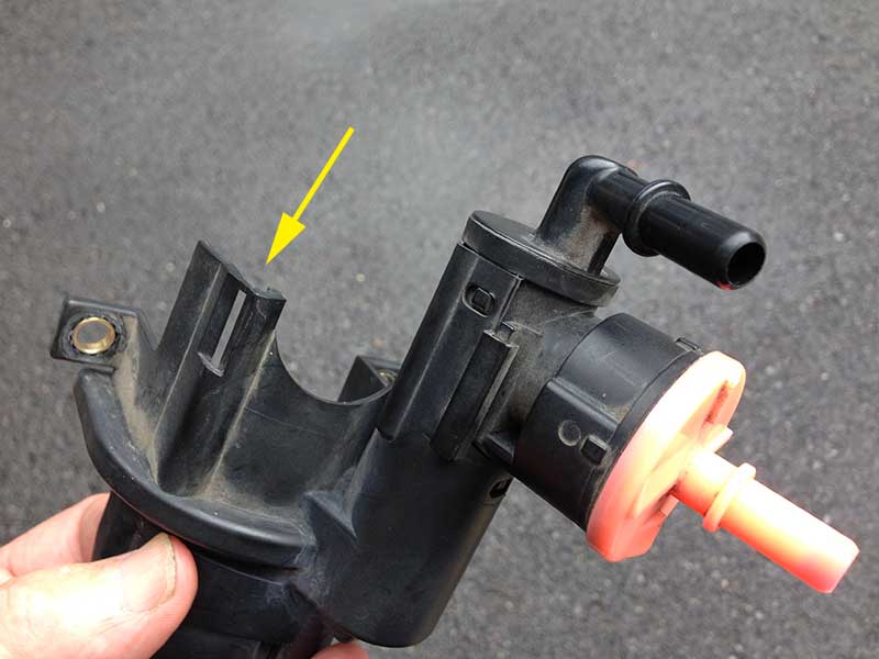

  8. Machster, this is the switch you need.

  12. Yes, I have this same problem. A search will reveal numerous posts that cover this topic but I have yet to find the solution. I have changed the gas cap, changed the gas tank bleeder valve ( attached to the filler tube), tested the valves with my Durametric and vacuum gauge, and blew out the lines with compressed air. Same old.

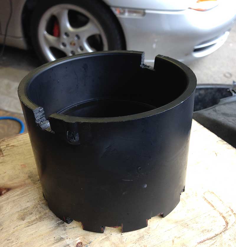

  13. Here's the tool I made from a 4" ABS fitting to remove the gas tank lid. Worked fine.
  14. Thanks to Gelbster in the 986 forum for pointing me to this post by Dale_K in the Pelican forum. In fact, it was the magnetic switch which was not inserted into the space provided for it in the valve. It had fallen out when I pulled the old valve but I didn't notice. I did see it but couldn't find any information on it until I saw this post If this unit isn't working you'll have trouble filling. Also the magnetic switch. A new one comes with a new vent valve.
