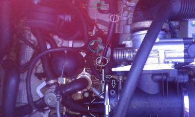

  4. OK, heres what i got, the turqouise circle, lines and arrows are what i beleve go the the throttle body sleeve, i dont know if the pink goes to blue or to red, same with green

  9. need help, it is a 98 Boxster 2.5 as you see in the picture the red lined tube is the one not in diagram, the blue and green circles i dont know where they go, neither the purple, now the yellow line leads to the back and that too i dont know where it goes, thank-you :)
