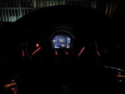

  7. I changed the two transformers the display worked for about 2 weeks and it's acting up again. It go on and off every time I hit the bumps on the road. First it was the analog that go bright or dim on its own. Now its the the display. The analog didn't do this before but the display was dark then it came back when it want to then it black again.

  9. Took the cluster apart fixed the analog lighting then I opened the door the analog light went out again.
  10. I did the soldering myself got the Multi color display back working nicely but the analog went dark on me. Will have to re turn somenofnthe dials. Got my fuel on empty most of the time when im 1/4 of a tank. So it would have to come back out again. I think eventually these display screen will go bad my screen is about 85 percent condition. Anyone have an idea where to sort replacement?
  11. I wasn't sure which one of the transformers to replace so I replaced them both. Will have to go over the details again tomorrow. Could be my crappy soldering skill.
  12. Ok this might be helpful I back tracked myself. I took the liberty to replace the two orange transformers at one go that maybe the one in charge of lighting up the analog display might not be sitting properly. So I will have to remove the cluster again and get things fix again.
  13. I bought my cayenne then the multi colors display went bad. Had a day off today so I took it apart to solder and fix to get the display back functioning again but I have another problem arises from this fix was now all the cluster won't light up. Only the dials light up but not the cluster behind. Any one know a fix to this? Picture say it all
