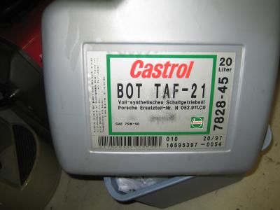

  4. Hey Loren can you please check the rennlist discussion on the tranny fluid as there seems to be some uncertainty regarding the amount, i.e. whether to fill it until it comes out of the fill hole- which is always more than the diy states or to simply put the diy amount in and call it a day. Thanks Sean I am going to change mine again and exchange whatever the hell I have for the correct stuff from that dealership. Maybe I should have them check my tranny beforehand etc.? Any suggestions? Again, I am worried they did sell me the wrong stuff and some damage might have occured?

  12. my second gear engagement has been pretty crappy lately unless is HOT, i.e. I drive the car hard for a while HOT. So I was worried it might not be the right fluid and really I have been worrying about the diff. I wouldn't even want to know how much that would cost to replace. I will probably go to the dealer and give them what I have left which is enough for another change and watch them give me the right stuff and then change it again when I change my oil next weekend. Thanks again Loren.
  13. so does that mean 1. that the container that I took a pic of is fine to use and is the same as that part number, or 2. that the fluid is maybe something different than what the container says? Thanks.
  14. So Loren I checked my invoice to try and figure out whether or not the fluid would cause any damage to my tranny. The part number listed is: 000-043-204-71 I noted that this part number is obviously different than that listed as approved. The dealer tried to tell me that that part number was approved for all P cars from 98-07???? It appears that my second gear and 4th are a pita to shift now. I don't know if the fluid is too slippery and is not letting the syncros engage or what but when I shift it into second say, it tickles the teeth and then goes in. I am wondering whether any damage occured and then it would be something to take up with them. Please let me know what the part number is for. I checked my pet5 and it didn't come up. Thanks sean Yes, there is a list of "Porsche approved" transmission oils as well as motor oils in the (Contributor's Only) TSB section.

  24. FWIW I have done the change before with the regular mobile 1 off the shelf from the local auto store. It is extremely hard to shift while cold. I then went to the auto gallery and they are the ones who sold me the castrol which makes it shift like butter all the way around. However recently after about 15k it seems like the fluid has broken down or something, and the syncros are not being engaged as easily- i.e. maybe too slippery, but dunno. I think I am therefore going to go back and get the oem part numbered fluid and go from there. BTW the castrol pictured that they sold me was what they gave me when I asked for gt3 tranny fluid. I asked for this because I have a limited slip. After talking with Jeff at sunset the gt3 and 996's run the same part number fluid FWIW. Loren also my tranny for whatever reason maybe becasue of the limited slip seems to use more fluid than a normal 996 and about the same as a gt3 maybe? I thought the increase in gt3 fluid was due to the tranny cooler though. In any event, back to stock stuff for me. Hopefully nothing bad has occured from the castrol. :)
