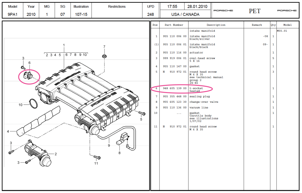

  1. Hi, I need the above part # for the wiring harness. The harness seems to have broken and I can't find the reference VW/Audi Part number for the harness. Many thanks in advance.
