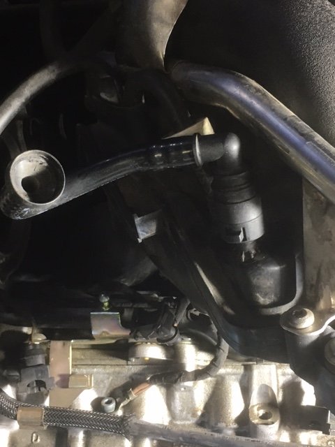

  4. I think I found it. It looks like part of the venturi hose. I am gonna just patch for now, and order a new one. BTW. Getting the starter out and in wasn't too bad. I loosen the back plastic support for the three coolant pipes. I had my daughter pry up just a few mms which was just enough for the starter to clear.
  5. Hello All, I am in the process of changing the starter motor on 2006 Cayenne S. I tried to be really careful, but the rear vac line where you pinch, broke off. I can't seem to fine where the other end goes. I was hoping someone can tell me at where the other end is suppose to attach to.

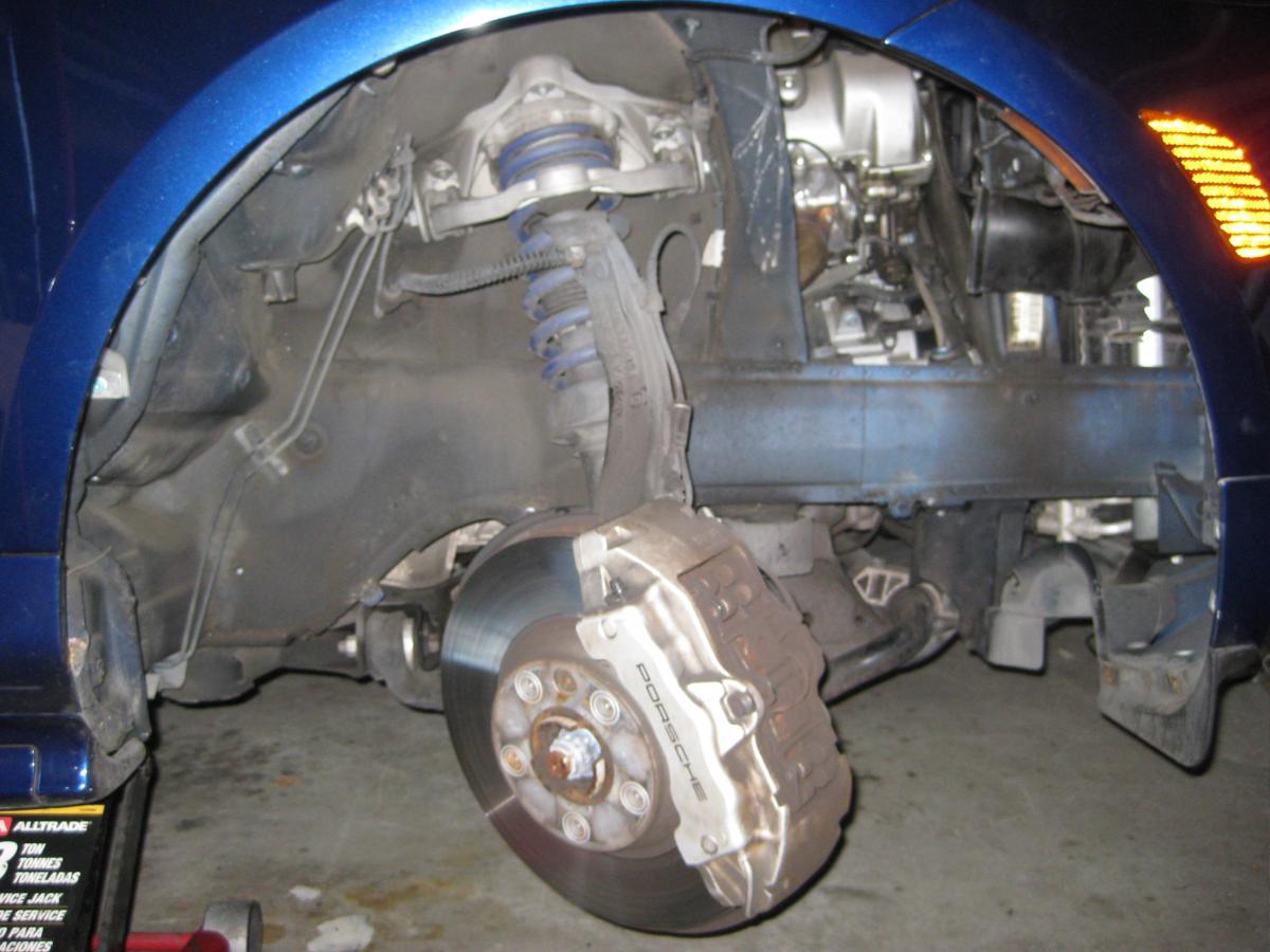

  6. I have a 2006 Cayenne S and replaced both pre-cat 02 sensors a couple of years ago. The driver was was pretty straight forward from underneath the car. I did remove the wheel well cover for easier access to route the 02 sensor wire. The passenger side I access via the front wheel. Here is a link with a little detail:

  12. Hi All, I've been meaning to post a similar procedure for 2006 Cayenne S. I guess this is a perfect time B) Procedure replacing the o2 sensor for a 2006 Porsche Cayenne S. Make sure the engine is cool. Parts: Driver-side O2 Sensor – Bosch 17157 Passenger-side O2 Sensor – Bosch 17158 Tools: O2 sensor 22mm socket 1” and 2” 3/4 inch extension 3/4 “ratchet 10 mm socket (passenger side air box and wheel well lining) T25 Torx screws (wheel well lining) Driver side O2 Sensor: 1. Disconnect electrical connector from the firewall. The brown connector 2. Jack up the car 3. Remove driver front tire 4. Remove wheel well lining (click here) for easier access to re-route the O2 sensor wiring 5. Remove Engine Under Tray 6. Access the driver side O2 sensor from underneath the car by the center hub. Use Pelican’s how to as reference. 7. Once the O2 sensor is loose, pull the wirings off the various harnesses. 8. Replace with the new O2 sensor 9. Re-route the wiring like the old sensor. Easier with the wheel lining off 10. Re-connect by the firewall Passenger side O2 Sensor: 1. Disconnect electrical connector from the firewall. The pre and post cat sensors are the same color connector or black. The inner or closest to the engine is the pre-cat sensor 2. Jack up the car 3. Remove passenger side front tire 1. Turn wheel full lock to one side in order to gain better access to the O2 sensor 2. Remove wheel well lining (click). Access to the passenger side O2 sensor 3. Remove the air filter box a. Remove 10mm bolt b. Pull out from the engine compartment side 4. You should be able to see the passenger side O2 sensor from where the airbox was sitting 5. Snake the O2 sensor socket over the wires. Hint: remove the wire from the fastener to add slack in order to tread the socket through the wire 6. Connect the 2 inch extension and ¾” ratchet, but in a reverse configuration 7. Break the O2 sensor loose. Remember, the sensor is facing in the opposite direction, so push the ratchet down or turn clockwise 8. Re-route the wiring like the old sensor. Easier with the wheel lining off 9. Re-connect by the firewall
