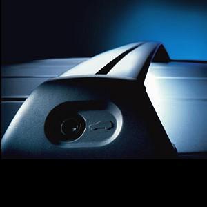

  1. Hello Gang I am having a little trouble identifying the part number for the rubber that goes in the middle of the horizontal roof rack for my 2005 Cayenne (roof rack part number 955-044-000-72) The rubber is "H" shaped. I suspect the TSB for the roof rails has the part number but I cannot find the TSB. Attached is a photo of the roof rail with the rubber (Photo "Borrowed" from an Ebay listing) Any help would be appreciated

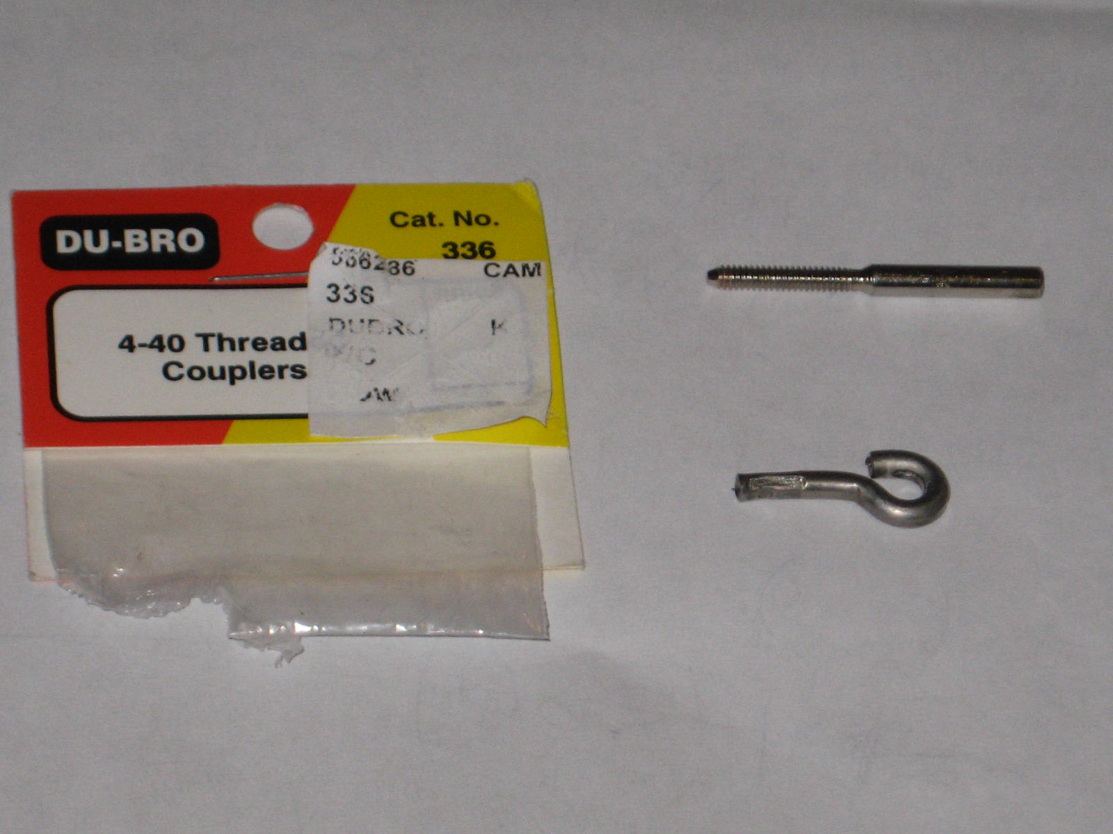

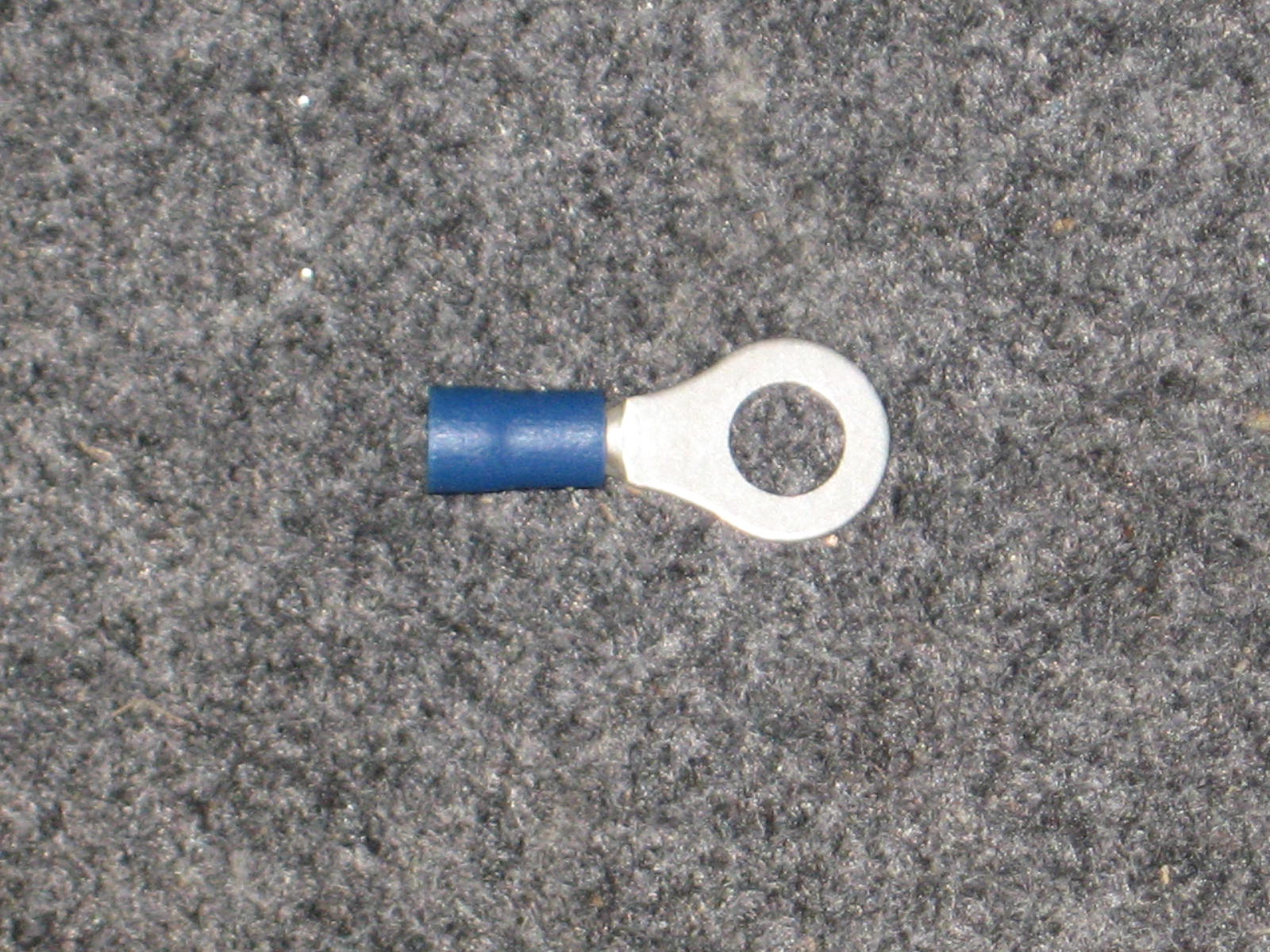

  10. I was able to repair my broken rear trunk latch this evening!! And the BEST part, it cost me LESS THAN $2.00!! Here is a summary of the problem and how I repaired it, however, bear in mind this write up is for informational purposes ONLY. I do not take any responsibility for consequences of YOU doing this repair. HISTORY I was unable to open the rear trunk using the key fob. I DID hear the solenoid click when I depressed the key, I WAS able to open the trunk using the manual release. I verified the broken electric release cable by removing the plastic cover of the rear latch by unscrewing the 2 Phillips head screws. Photo Below (sorry for the blurriness) Intact manual release cable (black stopper) Broken electric release cable (white stopper) I went to Hobby People and bought a package of 2 4-40 threaded couplers, $1.85 They are sold in packages of 2. The photo below shows the package the couplers came in, One of the 2 couplers and the broken connection which attaches to the electric release wire and the latch itself. I next used a regular soldering iron and solder to fasten the coupler to the broken wire. It took a little time to melt the solder just right. I imagine you could use an epoxy like JB Weld. The Photo below is actually the finished product but it shows a close up of the weld at this step (to the left). The next step was to put an electrical connector on the threaded side of the coupler. Below is a close up of the electrical connector I had in my garage. The beauty of this design is that the threaded coupler lets you adjust the position of the electrical connector to match up exactly with the latch. Once I got that length just right I soldered the electrical connector to the coupler. Now all I had to do was remove the clip holding the cables to the latch, remove the broken piece and replace it with the new repair. Here are two different angles of the final repair. Next I verified both the manual and electric releases worked properly, then I replaced the black plastic trim piece and I was done!
