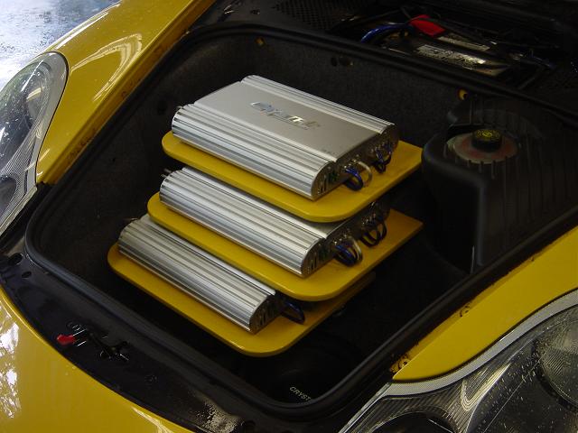

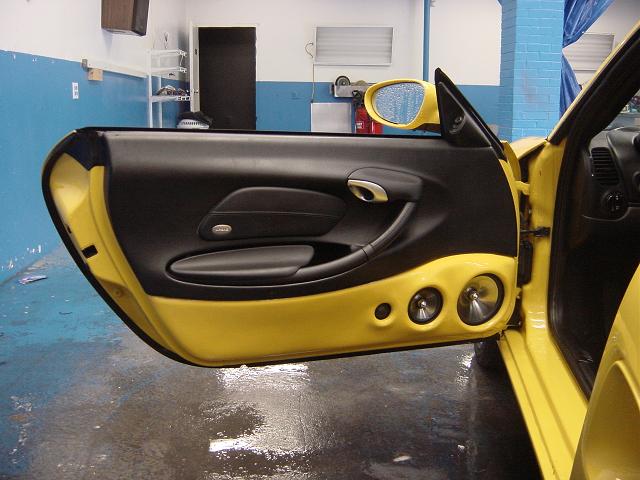

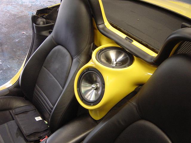

below is an email from when I was talking to those gusy a few months ago.
honestly, there are only two options for the box that makes it since it can only 6.5" subs, the jl 6w0, or hte elemental design eu700, i strongly recommend the eu700, cheaper and a lot more output than the JL.
a box painted silver with two eu700s would be around 1000 plus shipping
a box thats rough sanded with two eu700 so you can give it to a local body shop and finish sanding and painting is around 700
