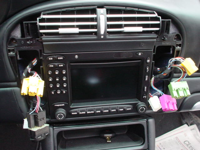

I'm probably being a little dense here, but my car doesn't seem to have separate switch side pieces next to the PCM-1 head unit.
(I'll try to attach a pic of my PCM-1 unit. These things never seem to work for me.)
My car has a single carbon fiber piece that holds the switches and surrounds the PCM-1 unit as well as the center air vents. Do I have to remove the carbon fiber surround? Does it just pull off or is there some secret removal method?
Sorry for being such a dunce. :(
--Louie
Yes loosen and move the horseshoe piece. The easiest method is to use a butter knife under the bottom edge with a soft cloth to protect the leather and CF. You do not need to remove any switches - just let it dangle.
Then press in on the spring clamps and pull the PCM unit until you can see connectors.

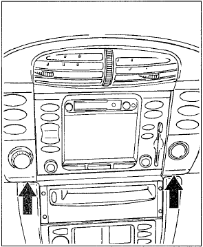

At the risk of bumping an old thread, the new PCM 2 or 2.1 has FOUR frigging clips, the upper two are not visible, being hidden by plastic.
Without the correct tools you need 5 or 6 hands- 4 for the 4 clips, then one or two to wiggle the POS out.
Study the sides, and you will see the bottom clip... study above it and you'll see what looks like the same constrution that disappears under the black plastic- yes, there are clips under there.
