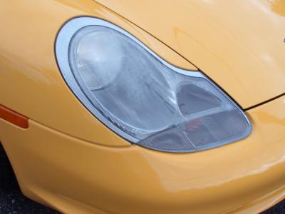

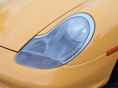

MY03, in the morning or after a rain, there is a lot of moisture inside of the light assemblies, this also leaves a haze on the inside of the plastic lens.
What is causing this and is there a way first clean them and then prevent it from coming back?
The pictures I took this morning aren't the best but should give you the idea...
