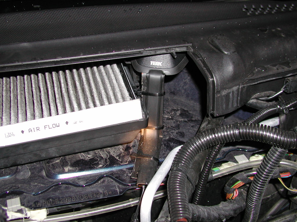

I had mine (Sirius) in the front by the cabin filter like in the picture. Reception is adequate but not great compared to the same radio in another car. I put mine on the clam shell panel and ran the wire:
on the bottom of the clamshell to the side,
down the clamshell arm,
under the rear padding by the drain holes and
down the door threshold and up to the receiver.
The reception is MUCH better.
