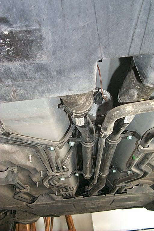

BTW, where is the fuel filter located? Is this something I can easily get access to and replace?
You will need to remove the plastic belly pan as it is under this and looking towards the front of the car. Here it is on a Boxster (996 is the same location). Gas will run down your arm... :(
Jeff's pic
I doubt if it is the fuel filter. It is supposed to be replaced at 60k miles.
If you do it at home you need to get the car in the air. Also need to remove the middle and rear plastic covers. This is when I did it on a friend's car.
