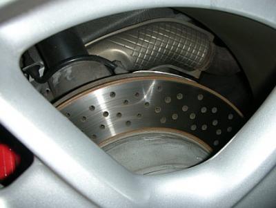

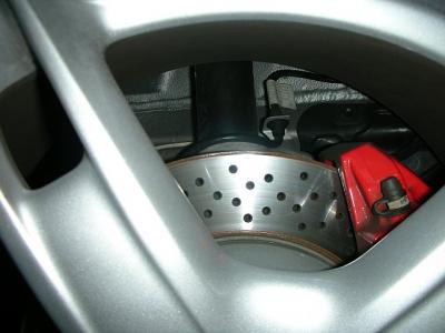

My car's rear brakes squeaked consistently and the service centre sanded away the edges in an attempt to eliminate the squealing. They sanded away the top and bottom edges of my brake pads leaving the middle in tact. Visually it is not nice as I checked out other 996 and the discs have no such edge rusting. I worry that if I don't change the pads, the rust will keep building up just like if you wash your car without driving it for a prolonged period that the rust would eat into the disc/rotor. Maybe I should consider changing the pads just to be sure.
I know any rotor/disc will rust even with hosing but usually the rust will be taken care of by application of the brake a few times.
However, on my rear rotors, now there are two distinct strips showing rust top and bottom due to the sanding away.
Advisor said the only way to get rid of it is by natural wearing till the pads are even again or I have to change the brake pads.
Should I be concerned? I mean visually it's not that nice but long term wise?
I wouldn't mind changing pads but at 7000 km is a bit early.
The advisor said on the TSBs, one of the solutions was sanding away the edges another being changed pads. However, he assured me that safety is not of a concern.
It could potentially also be caused my the city driving condition of HK and the "soft braking" habits of mine. I doubt that it had anything to do with bedding in the brakes because I believe that these stock brakes aren't racing brakes and they should be intuitive enough to be bed in slowly by any everyday driver.
Visually, it's really not going to go away not for a while but I worry the rust would build up to a degree that it hardens and get burnt into the disc.

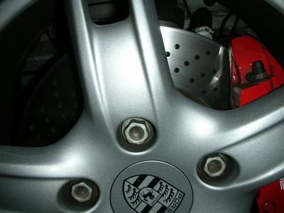

Front disc. No brake squealing at all. Loren for sure you are definitely knowledgeable enough to tell me. The dealer left the decision up to me and of course changing pads at 7000 km is at my cost and I wonder how long it would take for the pads to wear down so even contact can be achieved again.
