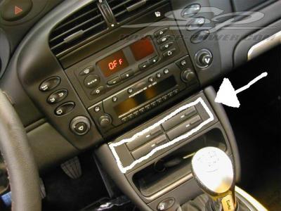

The picture below isn't my car but it should show where i want to put the motorised (single DIN) screen.
Thanks!
As long as the dvd player has analog outs, a modulator will work fine. Only thing I can see is the low end on the dvd's overdriving the amp (which is crap). Some 40Hz high-pass filters work fine.
