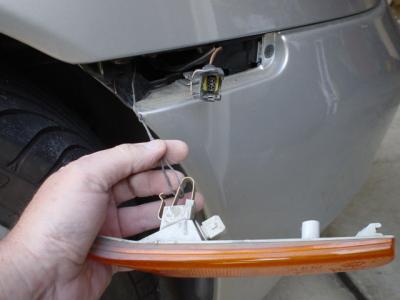

Mine was on accessible between the space of the headlight and the bumper cover, US version passenger side. With a flashlight, look for the shiny cable. Maybe be also by removing the side marker on the right side, shine a light and you may see it there too.

Thanks for bring up this topic, but I still can't find the cable to open my hood. I have a 1999 996 C2 Cabriolet. I pulled down the passenger side wheel cover and still can't find that cable. I even flipped open the side marker. Where exactly should I be looking? high side/low side? Toward the front? Is it a covered cable or is it a bare wire?

The cable I used is the shiny cable, flashlight and a wire hanger, between the passenger headligh and bumper cover. Should be in there somewhere.
The side markers hole, if you can see it, should be towards the front. Look like an aircraft wire with a loop on the end. The wire hanges made it easier for me to hook it and pull.

Remove the headlight and look for it so you will know where it is in case you ever need it. The thing is, it is not always exactly in the same place from the factory. Plus, if you have a used car, some people have done "hacks" and relocated the cable.
The first thing I did in 1999 when I bought my Boxster was to extend the loop end of the cable with a length of stranded picture hanging wire over to the side marker. Then we came up with the idea of relocating the cable to where the tow eye hook it. Both of these "hacks" make it easy to get to the cable.
