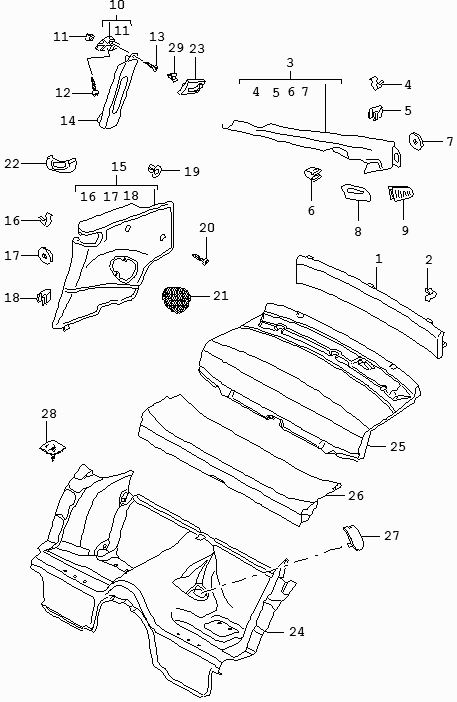

How to remove please?
Is this a coupe?
If so, that is all the rear linings.

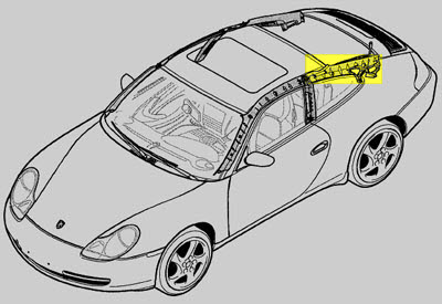

Yes its a coupe; where's the piece(s) that goes around the side rear window(s)? I can't seem to find it in the diagram. Also are these pieces just held in with clips and meant to be pulled out? Thanks!
Yes, pull down towards the inside of the car.
http://www.renntech.org/forums/index.php?s...post&p=6609
Thanks Loren. Do you have the instructions to remove the lower piece as I'd like a look back there as well please? Are the workshop manuals readily availble for the 997 at the local delaership or even on-line, or are they only sold to professionals? Edited by 500
