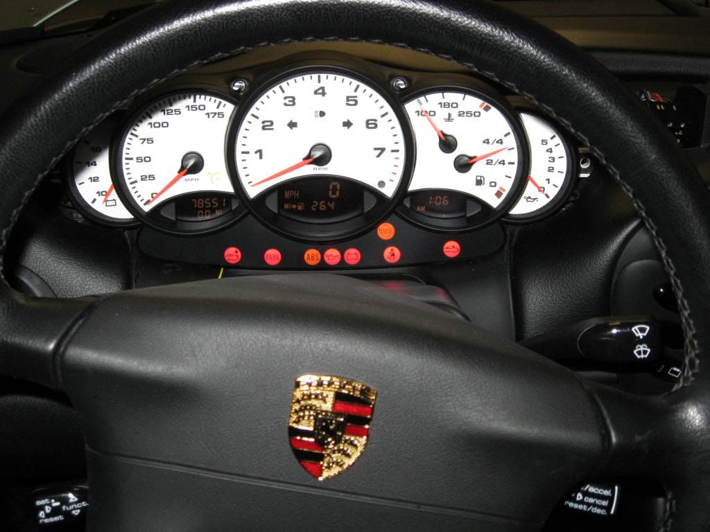

I purchased a used cluster - part number 996.641.980.26.70C fits a MY01 6 speed 2WD - US car for my 2000 Boxster. I installed it in my car and it works fine except for a damaged clock/oil gauge lcd. As you can see in this picture. The oil pressure gauge reads 0, but it rises to between 4 and 5 when I turn on the car.
The lcd was not a surprise - I paid $155 for the gauge cluster (including shipping) and I knew it was from a warranty repair. So, it was a moderate risk/high reward situation.

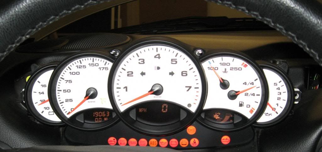

What I planned to do was place the gauges from the Carrera on my Boxster circuit board. The circuit boards have the same part number and they appear identical. When I did that, I had the result shown here:
Everything works fine except for the voltmeter. It stays at the bottom whether the car is off or on. I'm assuming that the car is sending a useable signal to the voltmeter since it works when I have the "pure" Carrera gauges in the car. Of course the circuit board could be similar in appearance but have differences.
