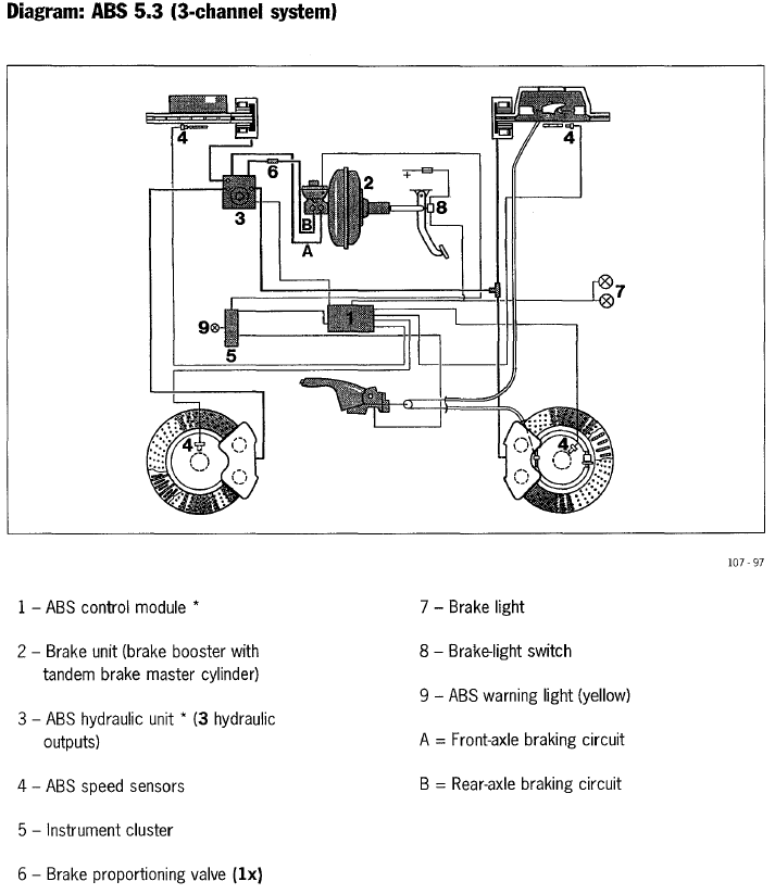

Even though they call it a proportioning valve (item 6 below) it is just a restricted line. There is no adjustment possible.
loren,
essentially which brake system component distributes brake pressure to each axle/wheel? thanks again
