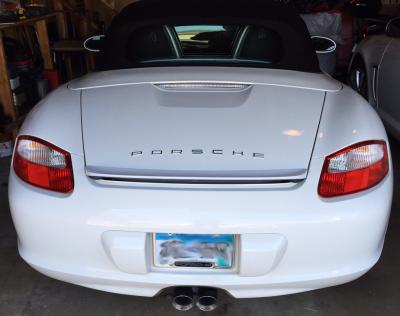

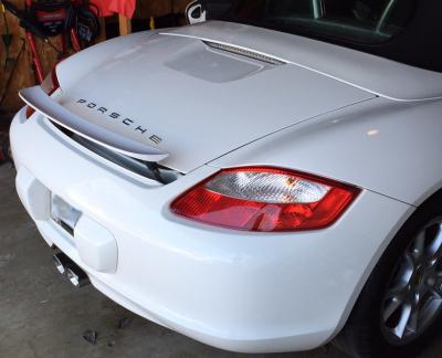

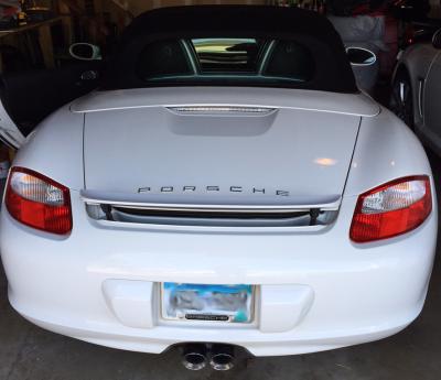

I ordered all the parts for doing the Conversion from Porsche, and it was a relatively easy job.
1. Order Parts:
• Cayman spoiler (lower): 987 504 623 00
 • Cayman spoiler (upper): 987 504 619 00
 • Oval HD screw (Qty: 7): 999 919 233 07
2. Prime, Base coat and Seal the upper spoiler
3. Remove old Spoiler
4. Install new spoiler
