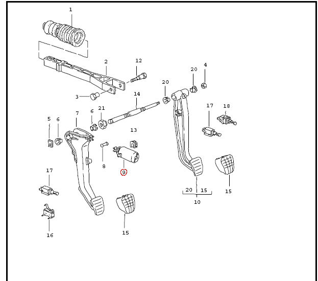

I took mine off 4 - 5 years ago. Clutch feel and control is much better, Here is a picture of the pedal assembly. Booster spring is #13. Make sure you lock the spring in place by inserting a pin or nail in the piston sticking out of the housing BEFORE you remove it so the spring does not pop out of the housing.

Took me a few minutes to get everything ready ( remove the vent piece and the cruise control switch ). Popped the C clip off without a problem. Used a screwdriver to move the pin to the side but ran into a little difficulty when I realized that the pin would not pop out of the housing. Had to depress the pedal a bit to get it to move the rest of the way and release from the pedal. Then had to figure out how to get the spring canister out of the mounting frame. Finally realized that I need to point the spring down while pushing the pedal down. This allowed enough room for the canister to drop free.

Can someone please tell me how to get the pin/rod out of the clutch booster spring assembly for removal on my 2003 996?  The clip came off easy and I was able to push the pin to the left (towards drivers side tire) but it hits metal framing parts before it is clear to push all the way out.  Am I supposed to then push "up" out of the clutch pedal assembly?  I am concerned that I will snap off that part of the clutch pedal.
Please help..spent 2 hours yesterday on it and am still light headed from being upside down!
