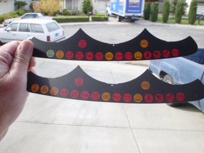

The car is a 99. Why? The reason I ask "why" is because it appears that when the mechanic (non-Porsche) replaced my damaged instrument cluster he put in a 97 or 98 cluster. Instead of a triangle with the exclamation point for the Traction Control Information light (goes on when system has to work), I have a circle with bars on the inside, but just on the left inside of the circle.

My instrument cluster looks like the top one, except the "TC OFF" bulb does not light up, so I guess I have to replace that bulb.
FYI, before replacement, I had the bottom one.

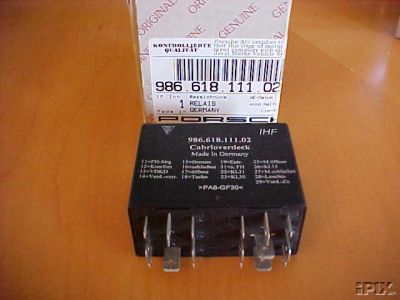

He said to check the top relay/control unit. The control unit is also the thing that keeps the motor running a few seconds when it is down and you are still holding the switch in the down position. The lack of the "grinding noise" and no light may both be related to a defective control unit.

Sorry, I thought by pointing out which picture matched my lights would be enough.

Regarding the relay, since I live in MT, there isn't really anyone else around to swap that relay with... I think a new one is about $60 which isn't much. I tried to remove it from my car, but it would not come out easy. Do they just pull out or is there a tab to push to release them.

The top relay just pulls out.
