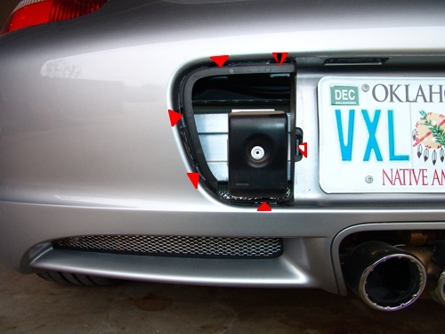

The bumperettes are held on by clips from the back side of the bumper.
You will need to remove the bumper to remove them.

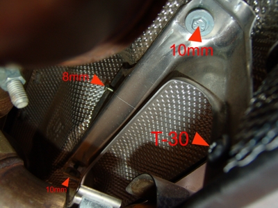

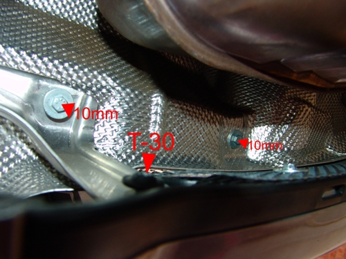

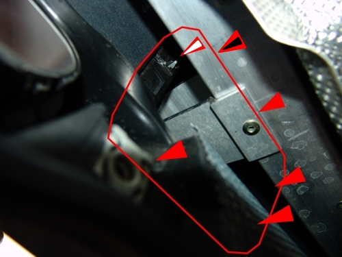

*look some pictures that i found showing how to remove.
