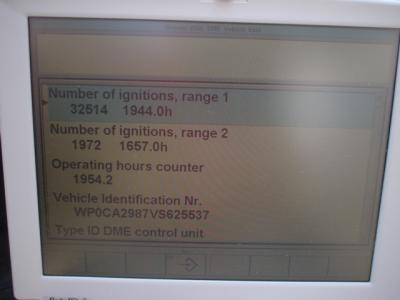

You were able to force the engine to spin past the limit of Range 1 while under acceleration into Range 2. Looks like the rev limiter can be beaten. Or, your DME has been altered to change when the rev limiter comes on.

So with these or any type of over-rev (on all Porsches, although I have a 987), this information is recorded by the computer?
Where can I read about what kinds of things are recorded.
Also I recall that the dealer can 'reset' this information, essentially erase it?
Yes, the ECU
Go to the Durametric site, it gives some good info.
Although it IS possible to do this, typically the dealer will NOT erase any of this information as it is used for warranty issues. Erasure costs some $$$$.
