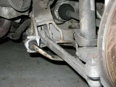

When I did mine, I used a long breaker bar to gently push the lower suspension arm down in order to install the bolt. Good Luck! Lou
Between the lower suspension trailing arm and the actual chassis, right below the CV joint, you just want to gently lower the suspension arm... Lou

Thanks for the photo, too.
