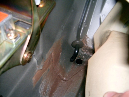

Have you checked the drain that comes from the battery tray yet? Water that runs down the windshield uses this drain. If it was clogged it would leak under the dash before it got behind the seat though. You may want to look at your right side floor up front too.
Luckily I found mine quickly from a musty smell that was water baking in car during the day's heat. In addition, I must have run over something that popped the drain tube up and knocked out the grommet leading to the floor. I'm not sure which event caused my wet floor but two things were certain, the drain was clogged and the drain tube was leading into my car. Neither are good for rainy central FL.

thanks for the help. The drain near the battery tray was clogged, so I cleared that. If that doesn't fix it, my plan is to pull the seat and the carpet, put the car under a sprinkler and see where its coming in from!
the water is coming from one of the 4 drains. there are two by the battery and two under the clamshell. if the carpet behind the passenger seat is wet, then it is the clamshell drain on that side that is causing it. if the carpet in the passenger footwell is wet, then it is the battery drain on that side. same thing for driver's side wetness.
i would not do the sprinkler test unless your alarm/locking computer is protected as i mentioned above. if you fry the alarm/locking computer you are going to have an expensive headache to deal with.
i would just make sure your drains are clear and check them periodically. you might also look for tears in the clamshell area foam barrier.
