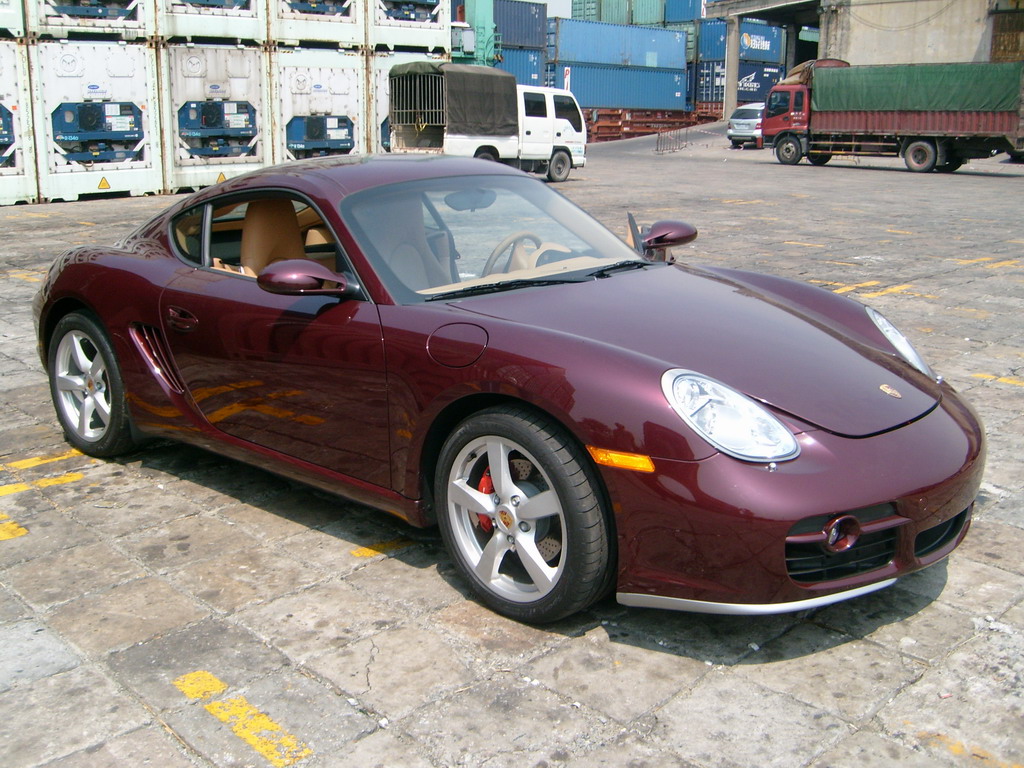

Here is the picuture I'd like to share with you, she is absolutely gorgeous!!!

The car looks great - congratulations.
Now that I see the car is new... Has the dealer run the Porsche PIWIS handover program? This is required for the car to configure country setting and the like.
