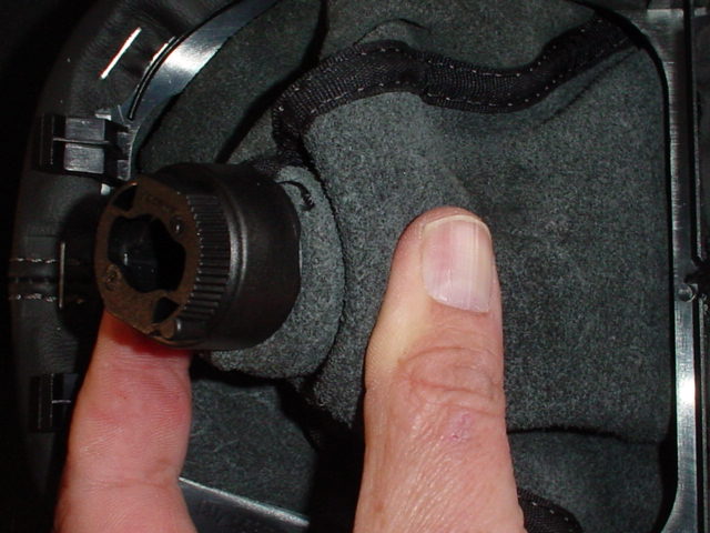

I have not done this myself. I watched a mechanic do it on a 987 when the 987 first came out.
Lift up the boot. There is a round black plastic ring. You need to rotate that ring to the unlock position. Then you pull like heck to get the knob off. The mechanic actually stood on the seats, reach down, and pulled the knob off.
I have seen pictures of it being done another way, but try that first.
The picture below is after it was pulled off. You can see the grooves on the locking ring.
I found it much simpler to lock a set of vise grips just below the shift knob then use a set of open needle nose pliers to lever off the vise grips to lift the knob. Using this method required very little force and I didn't have to stand on the seats and risk breaking the windshield like I've read happening to someone else.
