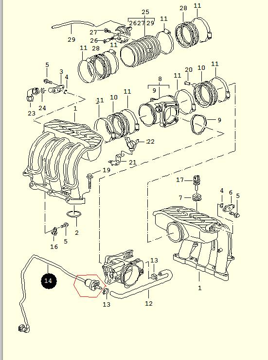

  18. Figured it out... I hooked my Boxster up to our shops Durametric software and ran the Drive Links section and activated the Fuel Evap Valve and sure enough I couldnt hear it click on & off like it should once the durametric software tries to activate it. So I gave it afew hard taps with the knob of a screwdriver and sure enough it started clicking on & off and the honking went away... Part number is 996.110.129.05 circled in RED
  19. I would check for oil in coolant..... Also check compression on each cylinder. does your temperature gauge rise? check your water pump to make sure the pulley is still there. m Sorry, No im not having any cooling issues what so ever... This problem is related to vacum and Emissions components. All my cooling system components are there and working.
  20. Hey Guys, I need some help diagnosing an issue im having with my 97 Boxster. One day, Im driving 65MPH on the freeway when I hear what sounds like a handgun being fired from inside my engine compartment... The engine didnt hickup or anything but once I was off the freeway the Idle was alittle unstable, moving from 900 - 1100rpm's and I got a CEL with 1 code (P0441 Fuel Tank Ventilation System - Above Limit ) She sometimes stalls during idle and will take about 7 seconds of cranking to start back up & sometimes comes close but doesnt stall. Also, when I turn off the engine after about 10min drive I'll hear a sound similar to a low toned 1 second honk coming from either the passenger front Fender or engine bay... Hard to tell, really. Any ideas what would cause all these symptoms?
