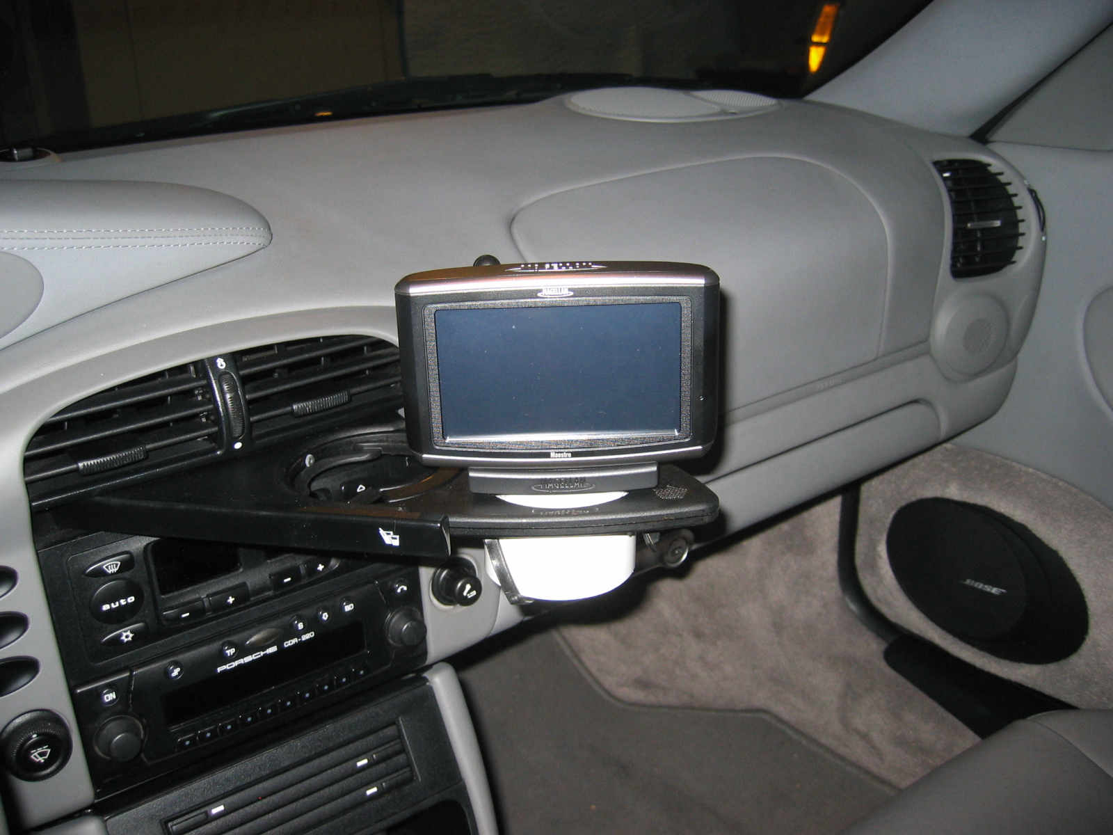

I have seen a few posts on after market GPS systems and thought I would give folks an option that does not require any installation. I purchased a Magellan 4050 from Costo for $499. This GPS includes birds-eye view, bluetooth and voice recognition. Utlizing the cup holder in my 996, a 2 inch diameter piece of PVC with inset cap and heavy duty velcro I was able to create a portable and easy to read solution that doesn't require mounting on the windshield. Both the GPS and PVC holder fit in the center console. See attached picture for the end result.

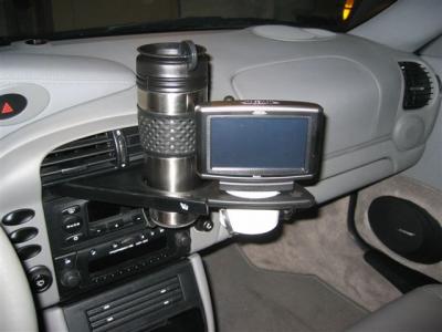

Ooohh, Mike that is good thinking. I got the unit for Christmas last year, and placed it on the lower left side of the windshield, nearest the driver. But I like this better, I don't use the GPS that often and your idea makes for an easy removal. How much does it block the second cup holder? That would the only concern, since I use the GPS on long trips, same trips I would have a water bottle there.

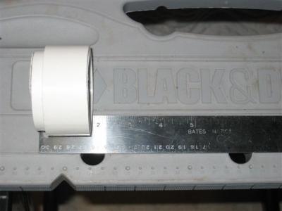

Regarding your question on the water bottle, I presume so. I have attached a picture with a travel mug and also a side view of the PVC for your reference (note, that if the PVC is too long the GPS will teeter...it needs to be just long enough to rest in the cup hold base, but sit flush on top).

It hasn't been an issue so far both speed and navigation are accurate. Izzy's option seems better in that you can snuggly fit it into the cup holder.
