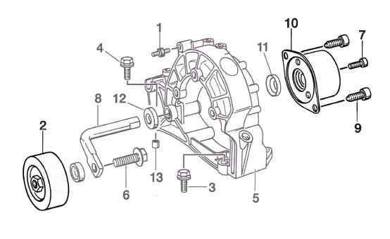

Sorry, can't answer your question as to whether you should change it. However, here's a diagram of how the roller attaches. To remove, you turn it counter-clockwise while countering on the bolt it is mounted on.
Good luck!
