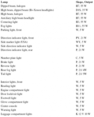

looking for type and rating for rear tail light bulb. My 2004 owners manual does not show the type and rating for this bulb. just trying to save form pulling out he other side if I don't have to .
Also the diagram in the manual seems to be incorrect. it shows the brake light where the tail light is, the turn signal whre the reverse light is, etc..
