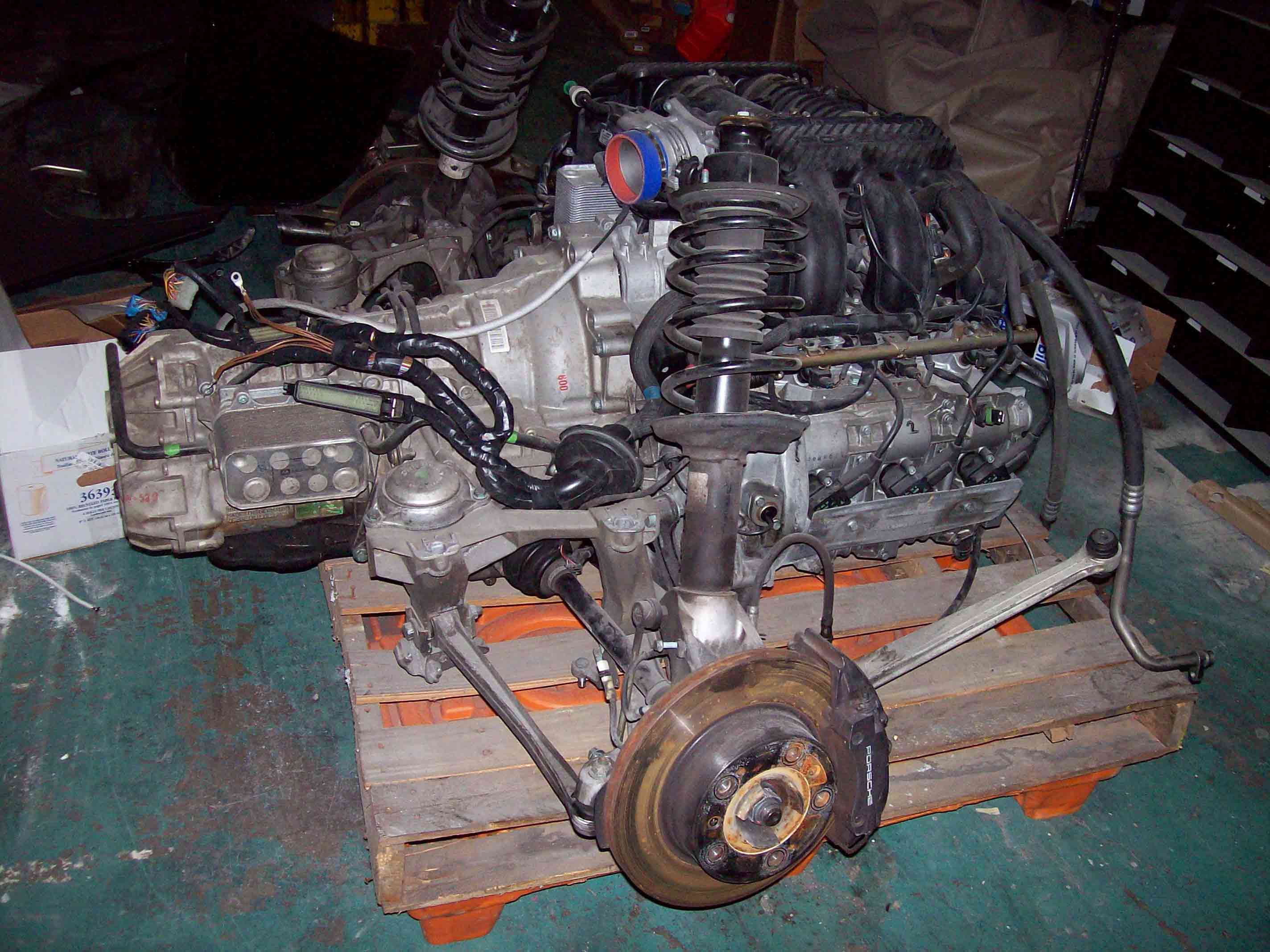

Here are some pics from the first few days of the conversion:
this is my 98 boxster engine with 55k

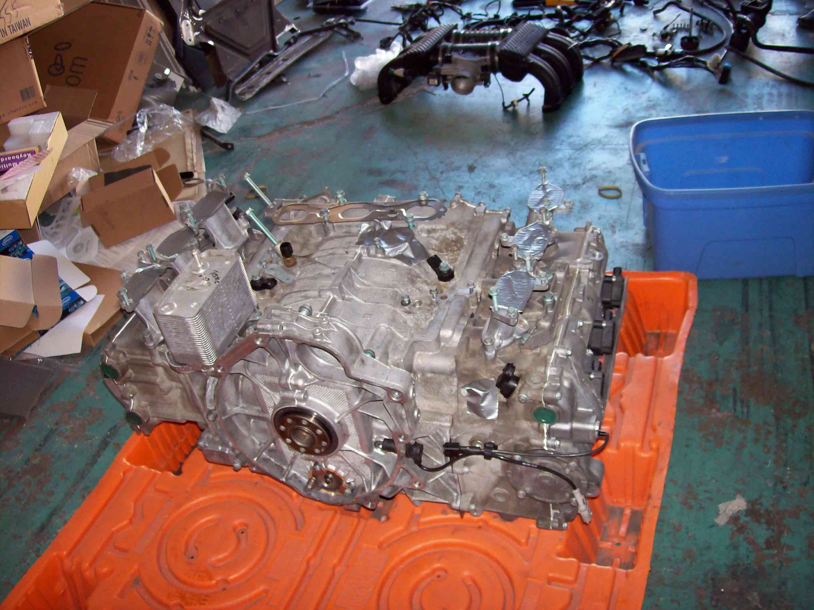

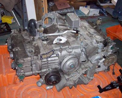

this is the rebuilt 996 motor

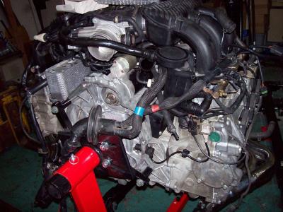

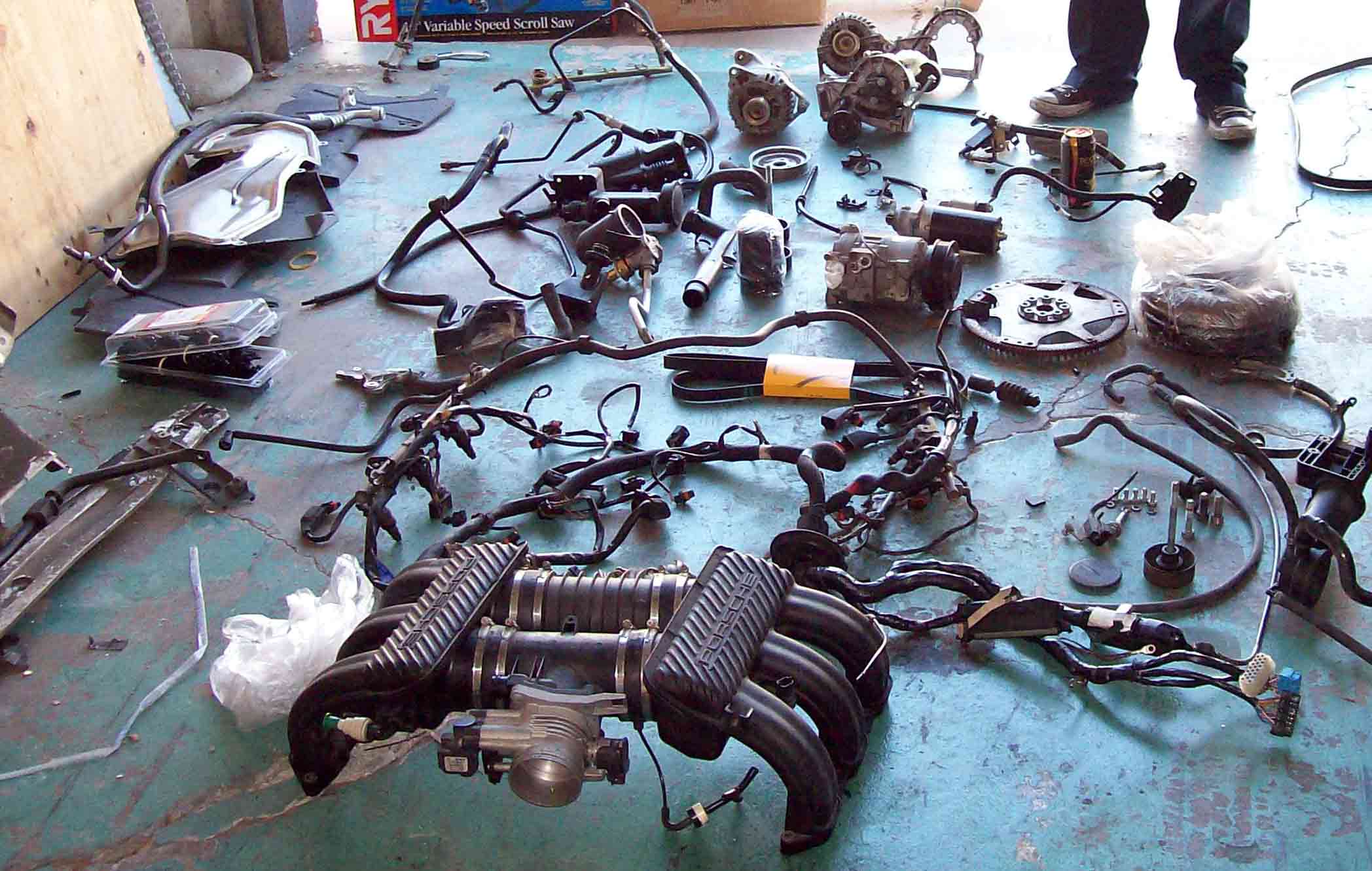

parts to go on 996 motor
996 engine done

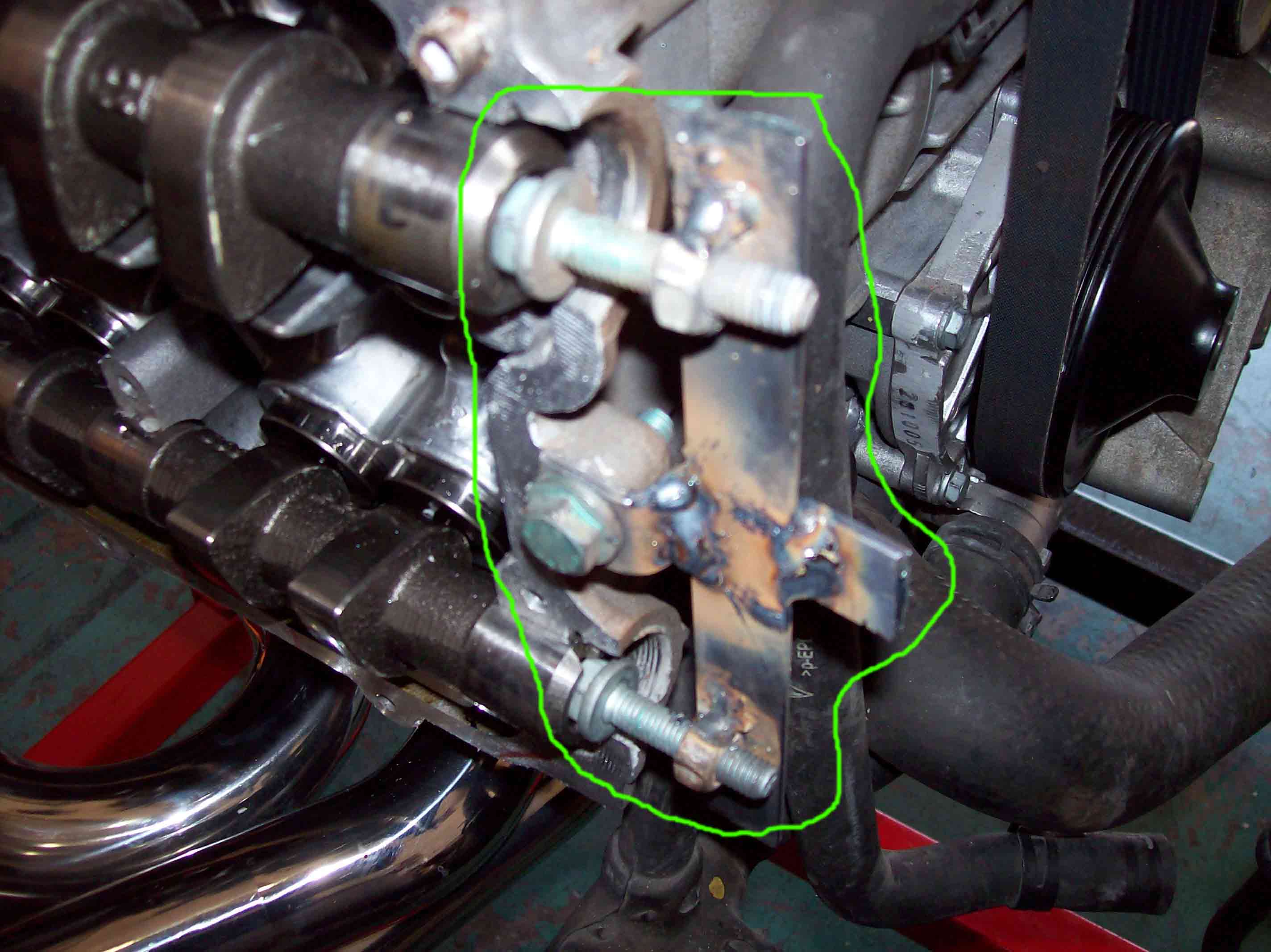

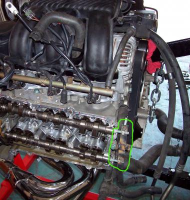

i realized i cut the solenoid wire by
mistake so i made a tool to hold
camshafts in place so i can swap
solenoid

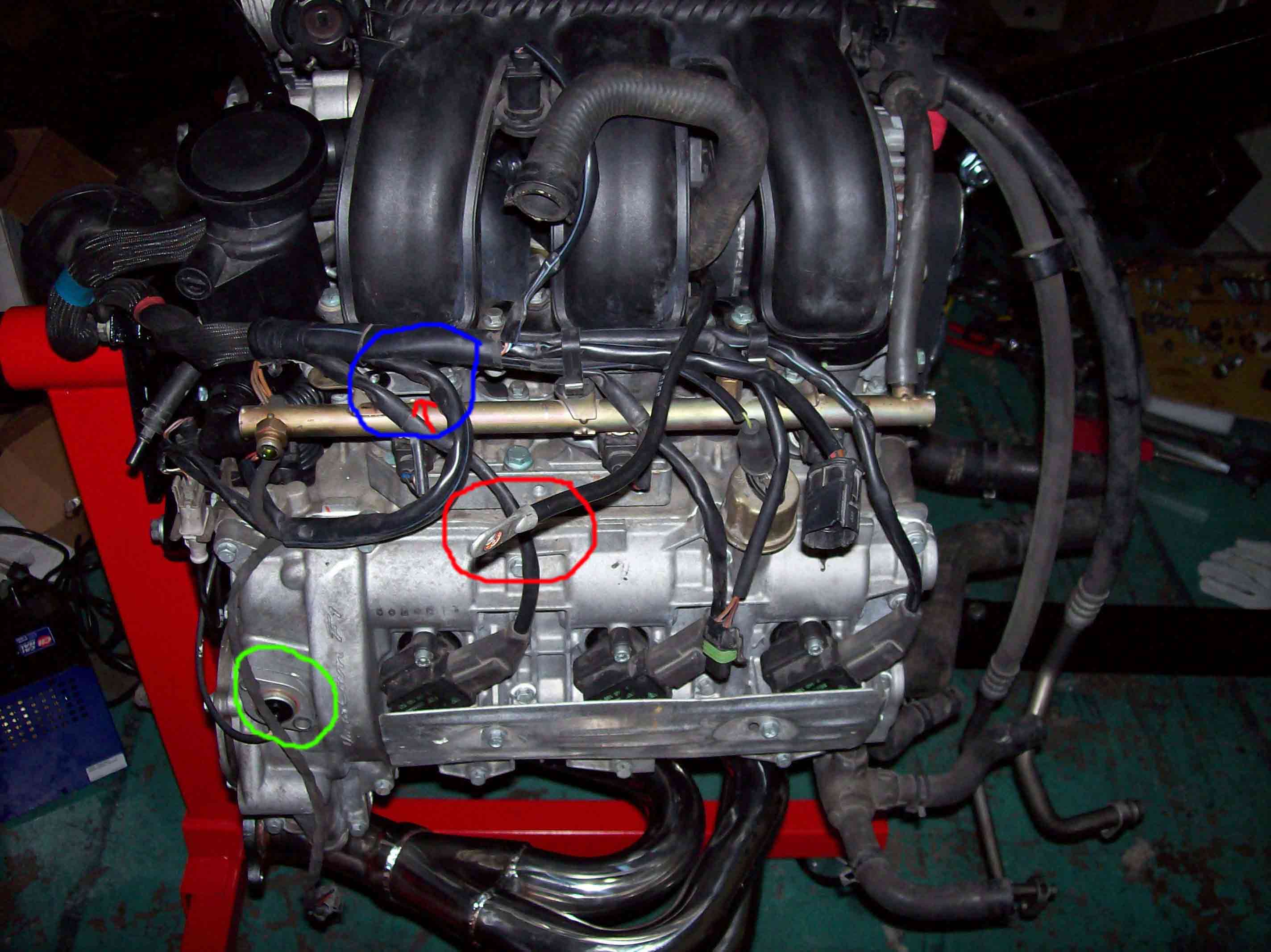

the green circle shows new solenoid,
blue shows the bracket i made for
fuel railing to fit 996 motor, then in
red the ground cable."notice the 3.2
sports headers"
this is the 996 motor ready for
transmission

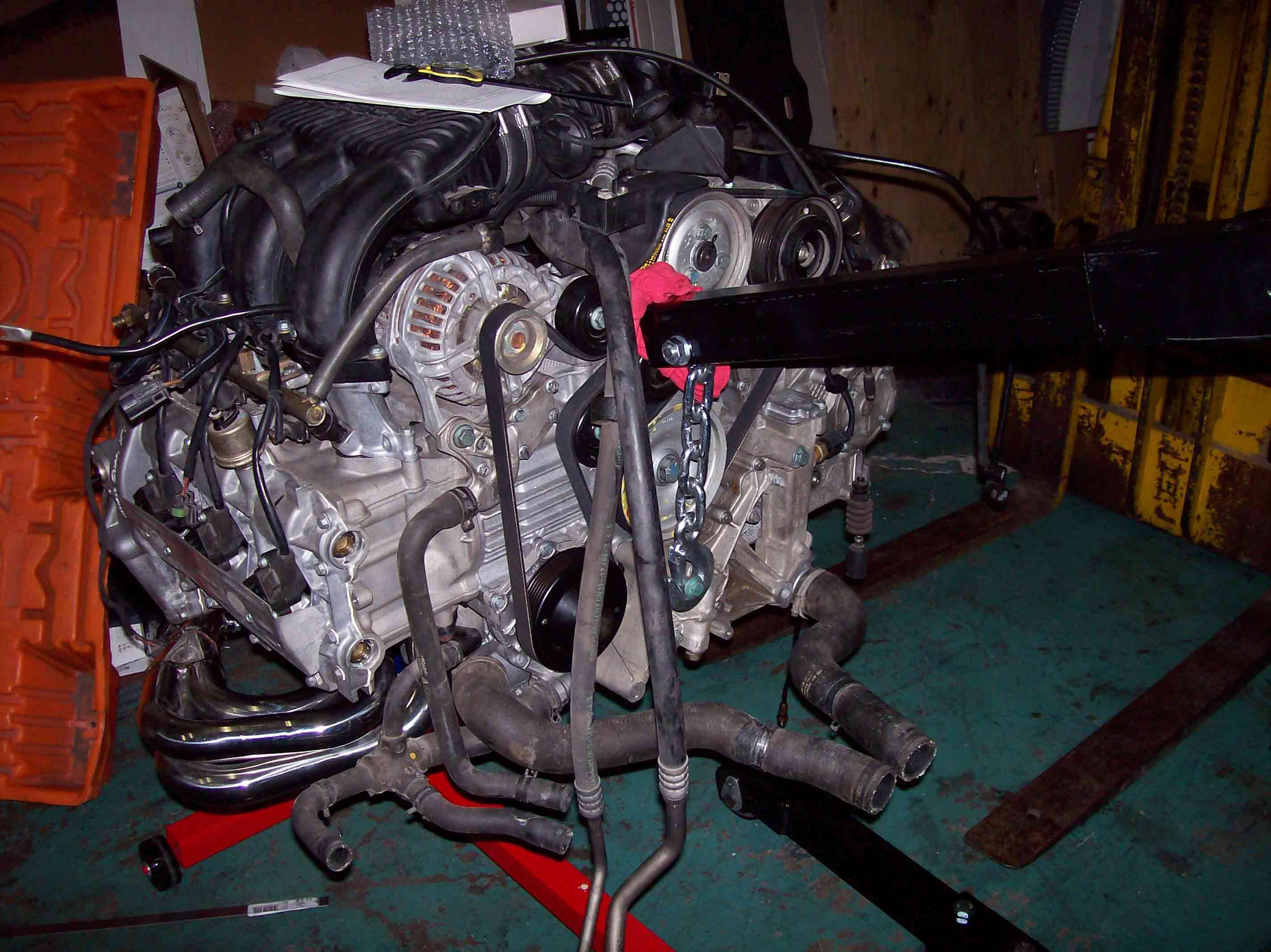

and finally the 996 motor with
the boxster tiptronic transmission
, good to go
