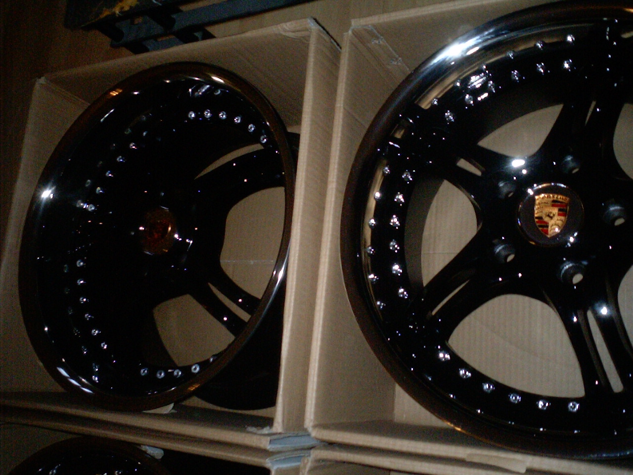

These are from eurotech wheels. 18x9 & 18x11

:) UPS guy brought a couple of boxes today & it was my toy I've been waiting for.
I think these wheels r just gorgeous! What do u guys think?

Sure! to start with for the front wheels to fit my "S" I needed a pair of 6.5mm spacers! I looked every where for em. But I didn't want the universal fit kind. Wanting either hub centric fit or 5-130 bolt pattern factory drilled, I found a pair on automotion.com for $32.00 (set). Since I was just extending 1/4 inch out , I didn't need to replace my bolts. I've had Kumhos on my car previously ECSTA ATX? but this time I'm switching to Nexen N3000. I'll let u guys know how they turn out.

Nice! hey djomlas did u use your fatory lug nuts? 140mmx1.5 or?
nice, got the same ones. just paint those centercaps couse that chrome stuff looks nasty
they are actually 8.5 and 10, but if measured end to end they sure are that wide :)
used stock ones, just machined off the spacers on them.

The reason is I like the low profile 35 series, don't really like in 40' series. i also wanted to stay with factory spec-ed diameter which is 265/35/18, so my tranny doesn't throw that much! Since I got my tires today I need to throw them on. But I talk to Frank from Eurotech wheel again! offset for these wheels r 52mmF/58mmR .Can u do me a favor? djomlas look in your factory manual see what is ur factory offset spec when its 18?

you dont need anything for the front, but if you prefer them to stick out more then you can put some.
they look fine on my car.
and for the rears, it was just a slight rubbing on the shock, so i chose the smallest spacer available that i could find and put them on, and its fine now.

FWIW, I have 10's (et47) on the rear of my '02 S with 275/35s. Car is also lowered with H&R sports springs. When fitting, be certain the wheel does not rub on the parking brake cable, as mine did. I was clear all suspension and shock points, but heard this strange whinning noise that would increase in pitch the faster I went. Upon removing the wheel, I noticed a groove rubbed into the cable (fortunately not severe). All was was fixed with a couple wide cable ties holding the brake cable close to the rear suspension arm.
