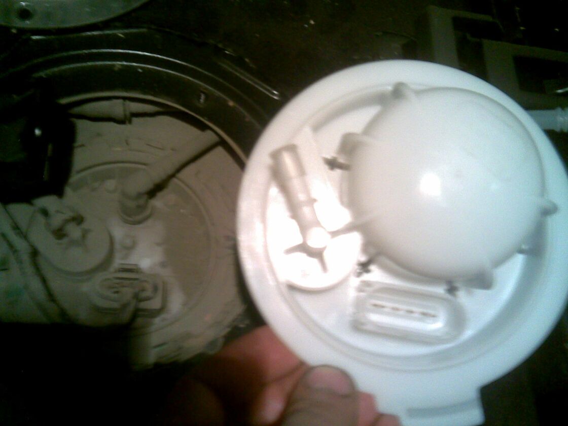

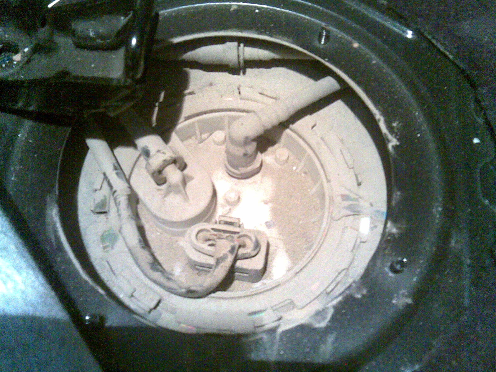

Thank you very mutch for help Loren i have attached fotos here you can see filter i just ordered 2 weeks ago fule filter and when try change it got problems my purchased filter not good for cayenne think shop wrongly ship me filter for vw toureg
Sorry, that is not a Porsche part number. A Porsche number would likely start with 955 or 999 (like the part number I gave you above - 955.620.841.00).
Yes i know it is not for porsche cayenne sport i just purchased it in usa shop. right now shop says he ship wrongly fuel filter and reguest me provideFuel Filter part numbe
