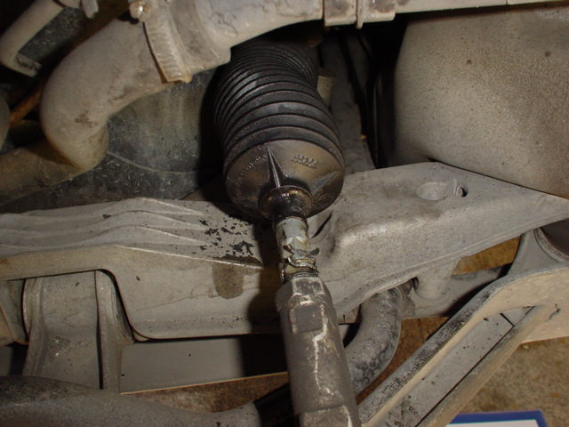

I was addiding fluid every couple of months. Nothing on the ground. The common cause is the pump return line on tracked cars. But nothing there.
Then I remove the small clamp on the power steering rack bellows and pulled back the bellows. The fluid came out. A bad seal.
I have a January 1997. If that is also your problem it is not common. But Porsche is on the 7th generation rack. Since my car is so old Porsche does not even want my rack for a core.
