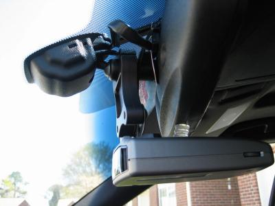

here is something I found from another thread on another site.
I am not sure if the mounting pattern works for you but it's a thought.
http://www.countryjoycrafts.com/ConnectorF...darDetector.htm
here is what it looked like on this guys car.

I'm not sure if these would work on the boxsters. In looking at my mirror mount, it's oval (kind of enlongated oval) ... these mounts looks like it requires a round mount!

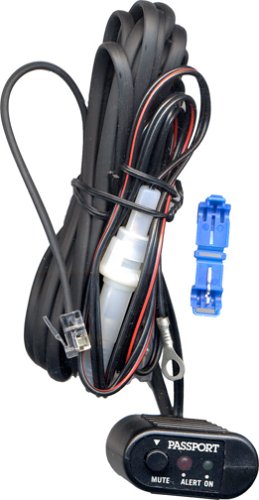

U will need a Escort direct hard wire kit(escort.com/2 types available) - allowing you to hardwire the power for your detector to the vehicle's fuse box so you don't have a power cord dangling down from the dash and plugged into a cigg lighter socket. So your radar wires can be well hidden.
In my case I tapped w/ my stereo circuit, since my aftermarket unit was drawing 1.5 AMP lower than stock cdr220. Or u can always tap to one of the vehicles fuse circuit u don't use much(side mirror heater,rear window defroster) power consumption is so low it shouldn't matter anyway,,,
picture shown above by Halo is also hard wired in, notice the wide flat wire instead of spiral cord? I did read ur previous post- yes u will lose sensitivity of laser detection. For maximum performance, your detector should be mounted level on your windshield, with a clear view of the road. Do not mount your detector behind the tinted area at the top of your windshield. This will reduce its laser performance dramatically!
