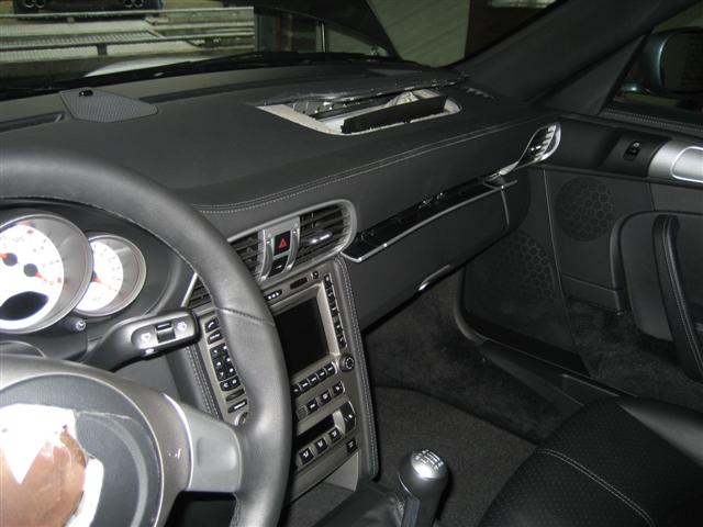

Thanks everbody but the drawing helped to remove some pieces but still dont know how to remove the dash itself
I also spoke to someone at the porsche centre.
He saided if the airbags came out you'll have to replace the entire dash
since there is an steel or aluminium plate underneath which bended under the airbag detonation
here's a pic of the problem

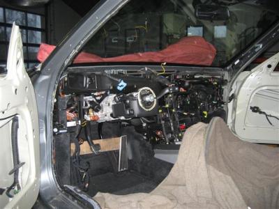

Went to porsche today and asked if they could help me and the printed me the entire service manual about how to remove the dash.
So that was absolutely great. If anyone is interested about how it is to be done send me a PM.
here's the pic when everything was removed after three hours of hard work.
