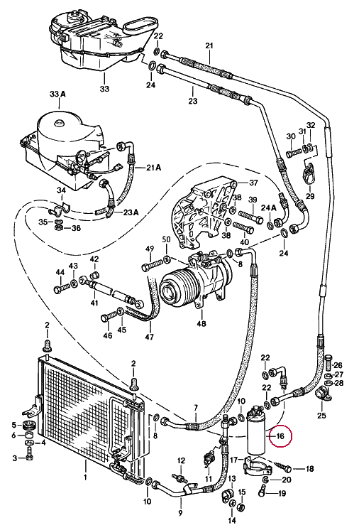

Most likely a leak and at least one bad seal somewhere. Most AC shops can test and find the leaks pretty quickly.
If the system has been open (or leaking for a long time) chances are the dryer will need to be replaced along with the leak fix.
