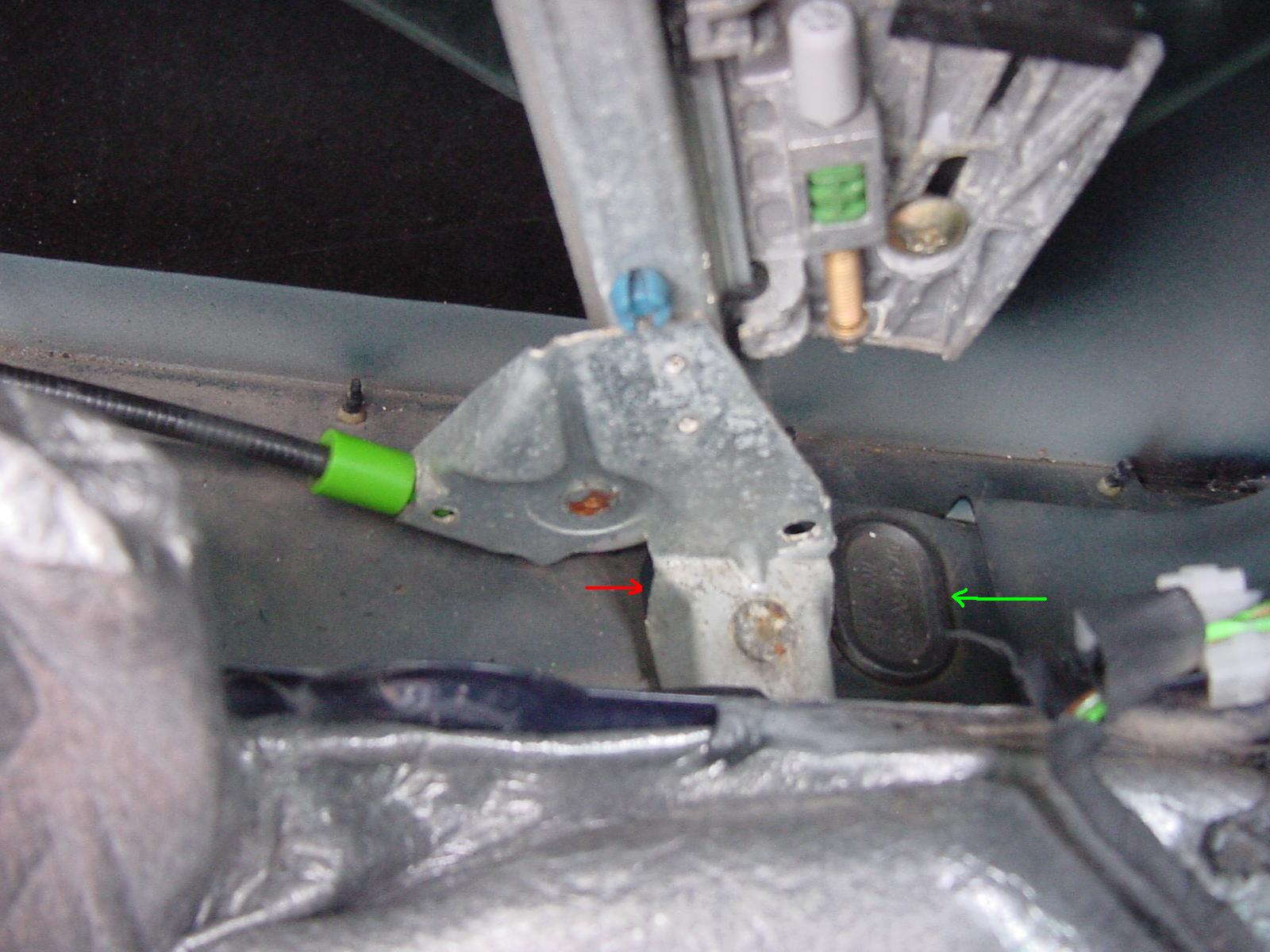

"There are four rubber plugs located on the door bottom surface. To adjust the height of where the window stops, you must first remove (pop out) the two OUTBOARD plugs.
Then, reach through the holes with an E6 Torx driver and turn the screws, one at a time until you achieve the desired adjusmtent. (Note, if you don't have an E6 Torx driver, a regular [1/4 inch drive] 5mm socket will work in a pinch, and will not strip the fastener). To keep track of how much you have adjusted, mark the top of the window with masking tape or, preferably with a wax pencil, tracing the top surface of the window where it meets the seal at the top. There is a little more than 1/2 inch of adjustment through this method.
Note that the Torx adjustment screws are on an angle, raked back at an angle similar to the rear edge of the door. Here's a photo that should help you get oriented:
Note: The green arrow shows the outboard plug that must be removed, at the forward part of the driver's door. The red arrow shows the very edge of the inboard plug (which should only be used to adjust the inboard/outbard angle of the window by means of loosening and then shifting each leg of the window regulator).
With a little patience, you should be able to minimize or eliminate the wind noise".
Mbodo, In your case, you may only have to adjust the rearmost screw. IIRC, you have to turn CCW to get that side to adjust upwards, but I'm not 100% sure.
