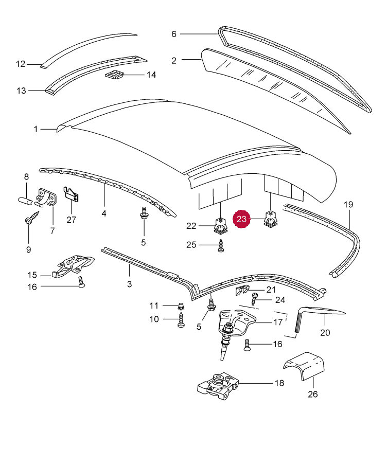

Does anyone know where I can purchase replacement plastic clips for my hardtop? Right now the interior panels are removed because half the clips are broken.
:welcomeani:

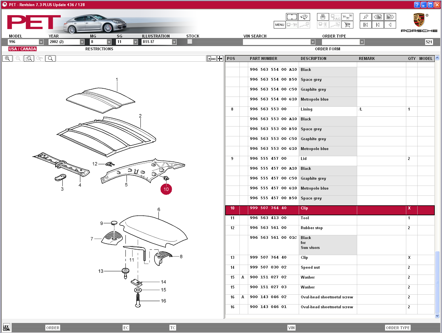

If you are talking about items 22 and 23 they are about $1.00 each from your local dealer. You would need 8 of each.
3 hours ago, Loren said:
Thanks for the welcome and quick reply. I did come across that diagram during my research. Mine look different then that though. I will take a photo tonight.
1 hour ago, Loren said:
Sorry, my bad - you are talking about the liner.
999,507.764.40  Clip -- US MSRP $2.40 each
Fantastic! Thank you very much. You rock!
